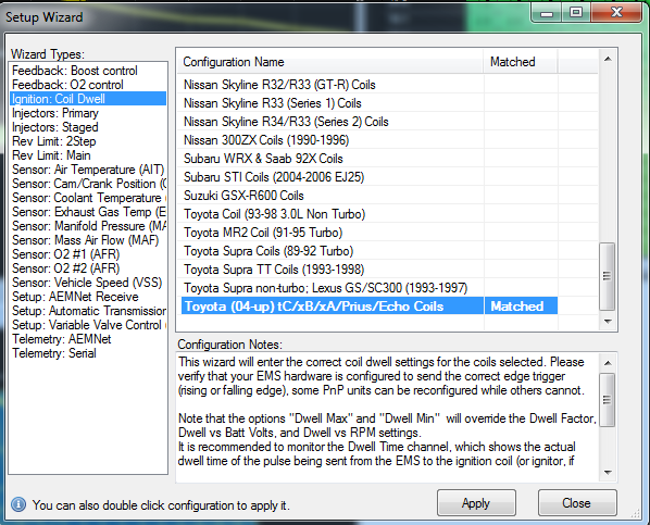

I put on this very nice set and well packaged coil setup on my car the other day. Makes the car run great, changed my a/f ratio like crazy from idle 2 wide open seems to burn fuel properly very pleased with the product. I had a question, has anyone experienced having to change the dwell time on the aem for these or running an aem and having coil drivers burn up. I am not saying these coils are the problem on why me drivers burnt up I thiink they where on there way out anyways is maybe why i was having my high rev. ignition break up.
I guess what my question is:
1 has anyone expericened burnt up coil drivers and why
2 what are the factory or what these coils dwell times are?
*Spoolin up coils are great and a well packaged product and the service is great!

There is a setting in AEM for Denso/Toyota/Prius coils. Haven't seen AEM in some time but that's what you want.
Checked out the coil wizard all i say was:
Mitsu evo 8
toyota 3.0L non turbo
toyota supra ect
Nothing denso specific, which toyota do you guys run or do u just turn it to mitsu evo 8

Just check my personal laptop when i installed the newest aem pro and it does have the settings for a toyota tc/xa/xb/pruis/echo coil the shop laptop must have very old software when i checked it cause it didnt have it.
Is the TC/Prius/Echo the correct dwell settings in EMS?
