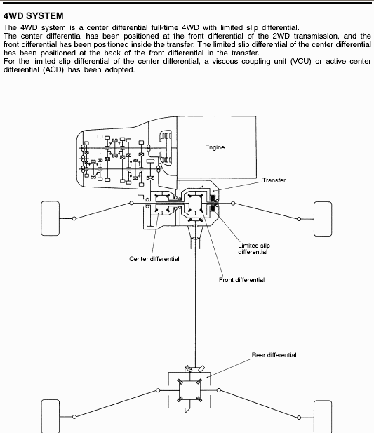

Originally posted by JT-KGY
??? still not clear...
Where's the front differential? in the transfer case or
transaxle?
Also, how do one know if the front diff is gone?
What are the known symptons?
Hi JT, here is something that might help:
transaxle?
the front diff is in the transfer case, the center diff is in the transmission.

Thanks jemm & AMS... !!
So it seems like switch open front diff to EVO RS's front LSD would
be easier by just changing out the transfer case then?
