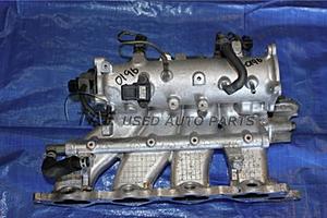

What about the extra metal that IX manifolds have compared to VIII for the IAT sensor that does not come drilled/tapped on USDM EVO's?
See attached pictures. Pictures courtesy of TAE USED AUTO PARTS. I'm not affiliated with them, just found them on ebay.
Would you like some A1 or Barbeque sauce or something? J/K
They will bolt on the exact same but an added positive for the IX is the tappable IAT molding as shown. Go for the IX.
EDIT: Just clearing up some information with evidence/understand the thread is dated. I still have condiments handy.
Off the top rope from my friend in north Afghanistan. So you are advocating that the EVO9 intake manifold is better suited overall than the EVO8, right?
Haha yes. If I had a choice, I would have the IX manifold and drill/tap for the IAT sensor (logging or SD) in that OE location.
