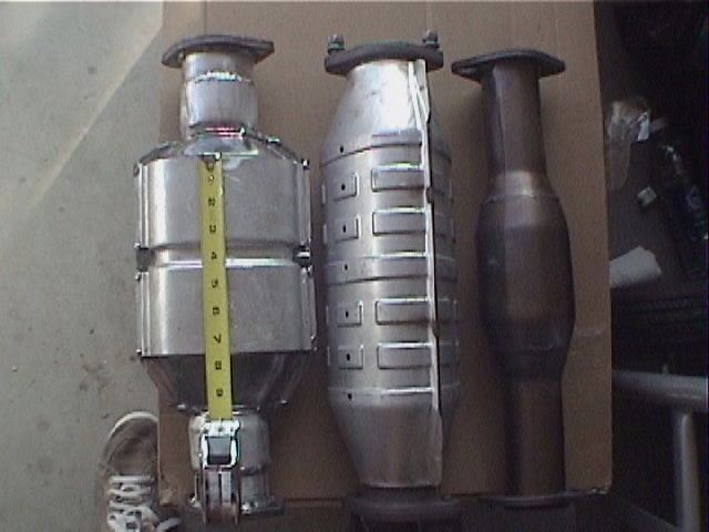

I hate to be a PITA but the Random and RMR Cats utilze 4" single brick designs, how is an 8" (duel brick?) going to flow better? The stock Cat brick is only around 8-9" inches long also, and it's unique triangular shape gives it a larger surface area compared to the aftermarket highflow Cats I have seen.
I do not know about the RMR cat, but the Random utilizes a very thin wall metal substraight spiral brick, that coupled with the short 4" single brick design is what allows it to flow significantly better than anything else I have seen or tested.
I have run the Random (2.5") with the stock ECU for 3-4K in my car with no cells. We also sniff tested it and while the levels were higher than the stock cat they did meet EPA standards. I now have a 3" Random, with the stock ECU I did not get any cells after a 500 mile road trip. I am now running standalone so...
I don't know anything about your cat, so I am not saying that it is better or worse than these others mentioned, but an 8" brick is certainly not a good enough reason to say that it is better. Can you tell us more about the brick and body design, maybe a couple of pics?
Here are some comparison picks of some of the cats I have played with.
Left to right: generic highflow, stock, Random 2.5"

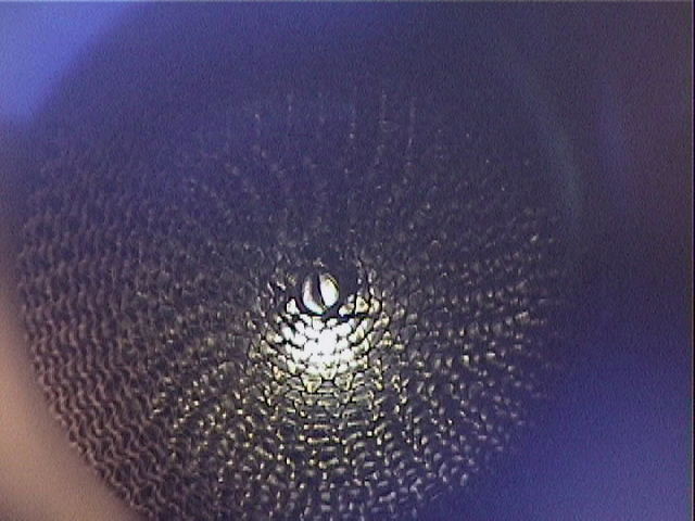

The Random cat brick. Can you see the light!

I was just noticing that these pictures don't really accurately show the differences, but at least it gives you some idea. While it doesnt look it, the high flow brick actually does have a slightly larger matrix hole size compared to stock, even though the pic looks differently.
Also the Random matrix is even thinner and more open than this pic shows compared to the other two.
Sorry for the pic quality but it is better than nothing I guess.
