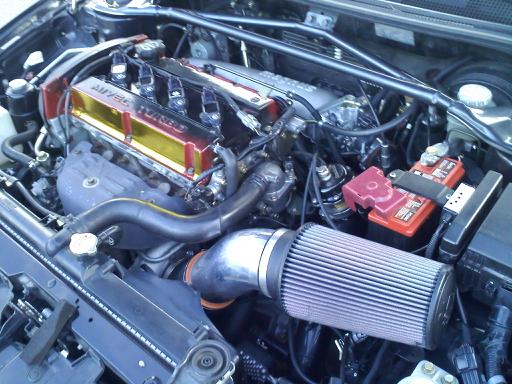

Originally Posted by Evoryder
Dejon 4"
Or English Racing's 4" intake... not on their website, but when I asked Aaron at ER said they sell for about $150.
More info HERE
