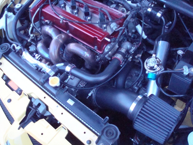

/facepalm
Please dont spend $140 on an SD intake if you are remotely handy with a hacksaw..
4 inch aluminum 45 - $28.95
http://www.racepartsolutions.com/pro...sp?prod=ALM-45
4 inch EPDM elbow - $14.95
http://www.racepartsolutions.com/pro...sp?prod=Rub-45
4x6 air filter - $29.95
http://www.racepartsolutions.com/pro...=RPS-Airfilter
Total - $73.85 - much less than that if you already have a filter.
Cut the 45 degree elbow right after the bend and paint it whatever color you want with a rattlecan (I used black thermotec paint because it dries fast and insulates), grab some 4 inch worm clamps from autozone since it's non pressurized and voila - you have a custom 4 inch intake.
Here is the one I made for my car - grant you I used an existing 4 inch AEM filter and t-bolt clamps but still..
