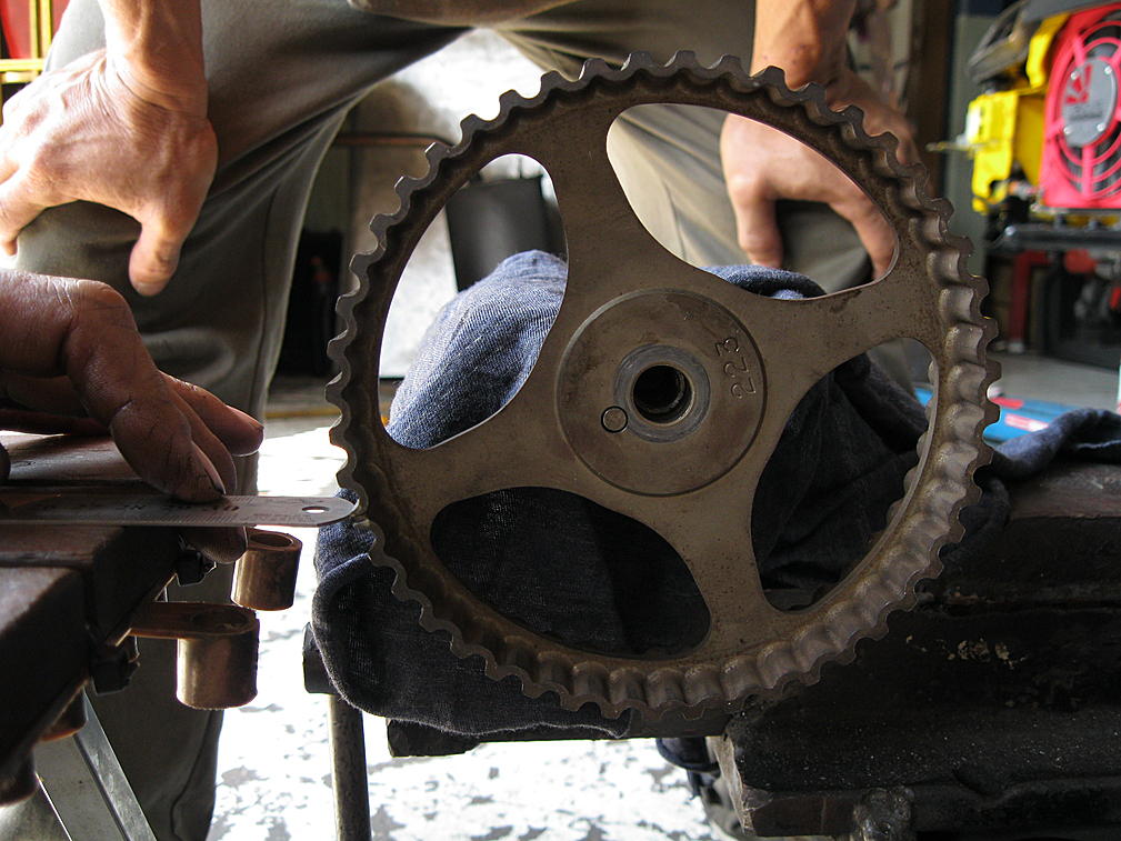

My Problem finally solved and all the frustrating episodes was caused by a faulty Cam Gears.
Please refer to the attached pictures as my mech have match the oem cam gears with the faulty cam gears....
The different of Oem & the faulty cam gear is 1 tooth.
Thank you GOD...
Thank you GOD...
