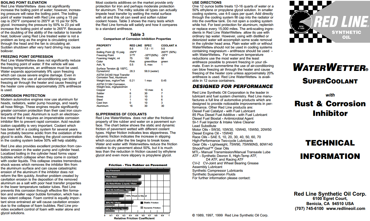

All the gearheads I know recommend Red Line WaterWetter and distilled water for the track. If you loose your coolant on track, you don't create a hazardous situation like you would with anti-freeze or standard coolant.
Keep in mind this is out here on the west coast were we don't see freezing temps.

^ interesting - a 50/50 mix? it's weird that the amsoil version specifically says not to use distilled water

Originally Posted by kyoo
a 50/50 mix?
12oz. WW to 12-16qt. distilled water as per Red Line directions.
OEM CT9A radiator holds 6.3qts, so you only need like half a bottle.
