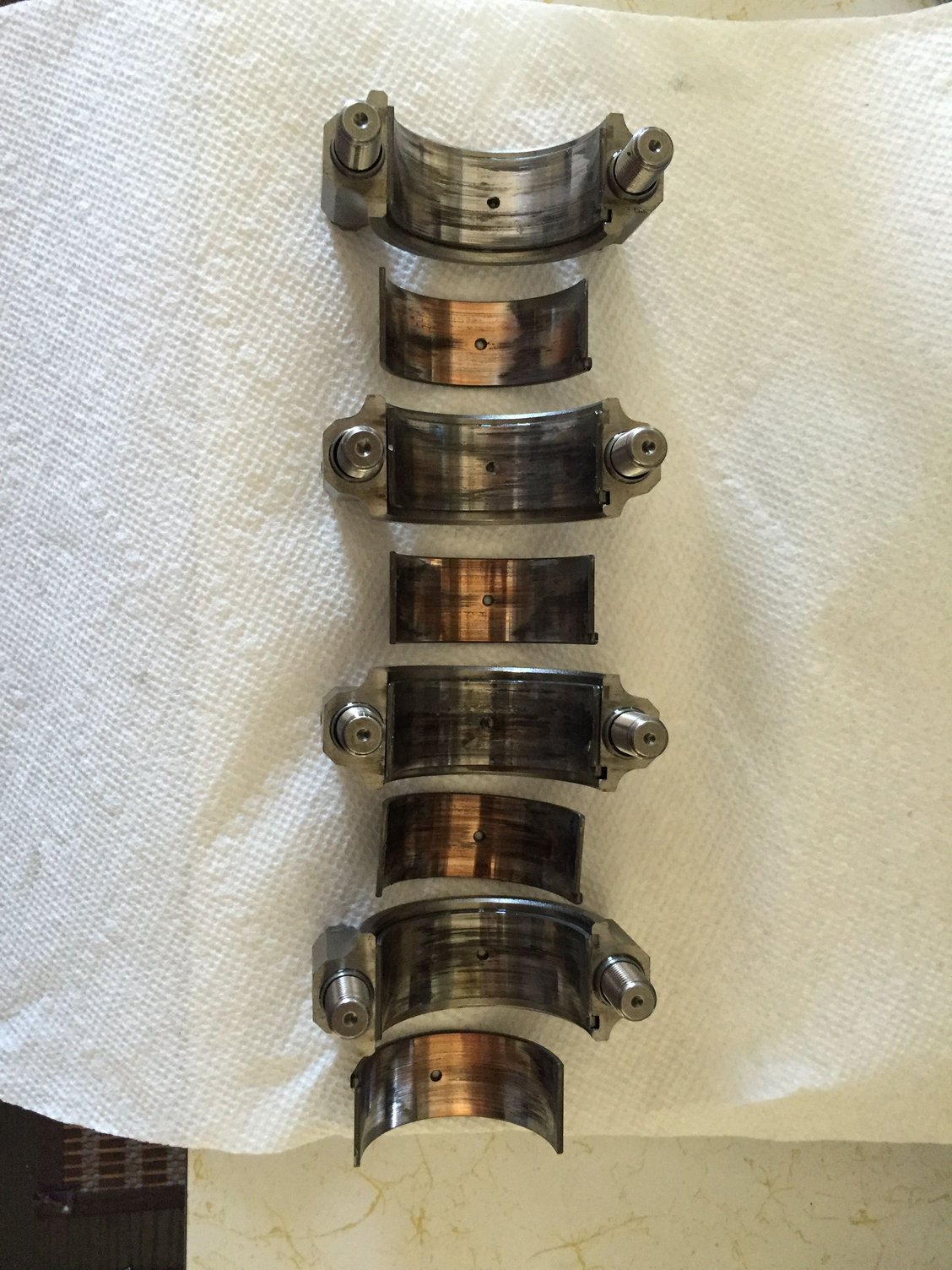

Hungry crank
So after about 15k good times weekend only miles and my last trip to auto club speedway the motor began to knock pretty bad on the 2nd lap of the last session so I pulled into pits and towed her home. And this is what I found.

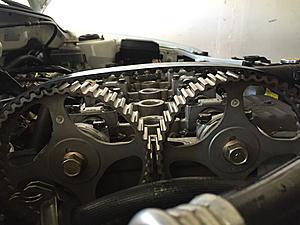

Not really sure what caused this. I did notice that with no spark plugs in and rotating the crank there is a point that feals like binding I then notice that the timing belt was getting slack while rotating past that pont. Perhaps the oil pump went to crap

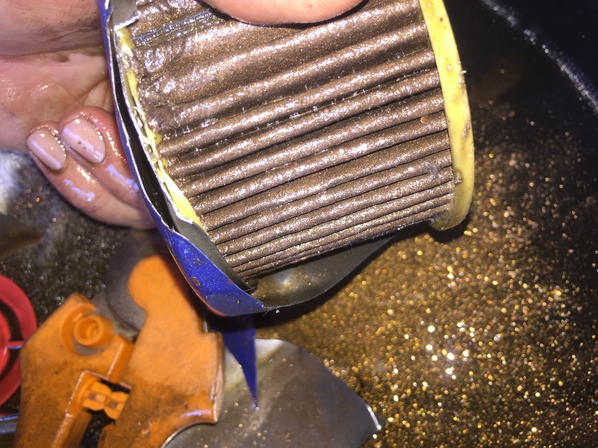

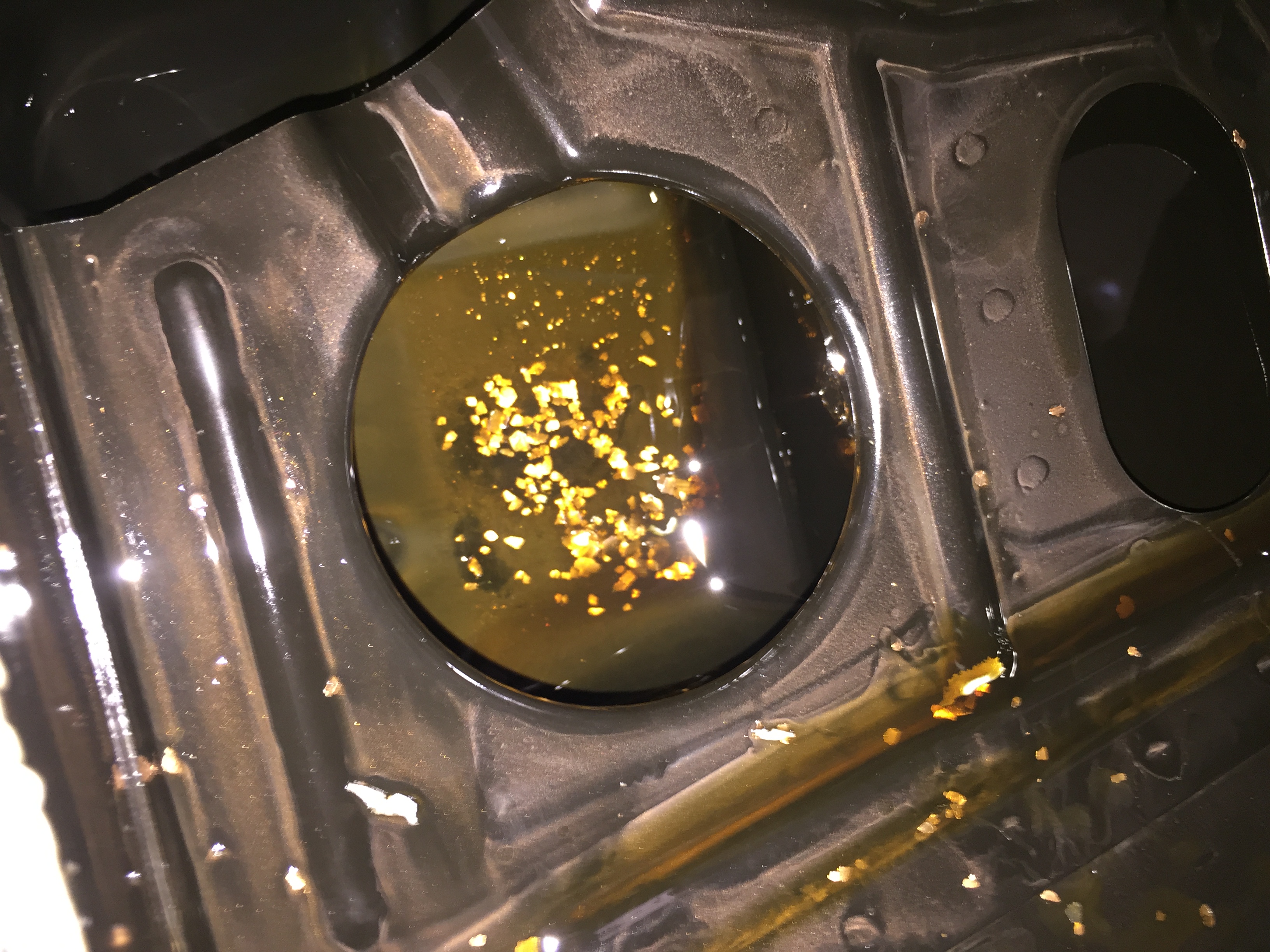

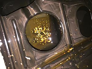

I just can't understand where all this brass/gold colored material came from. Between the oil filter oil pan and pick up it looks like enough material to make all new bearings yet it doesn't appear that there is that much missing from the rod bearings.

gold comes from the bearings... you have a lot to change, and you problems might have come from a multitude of sources... bad oil pump, bad balance shaft bearing.. etc..

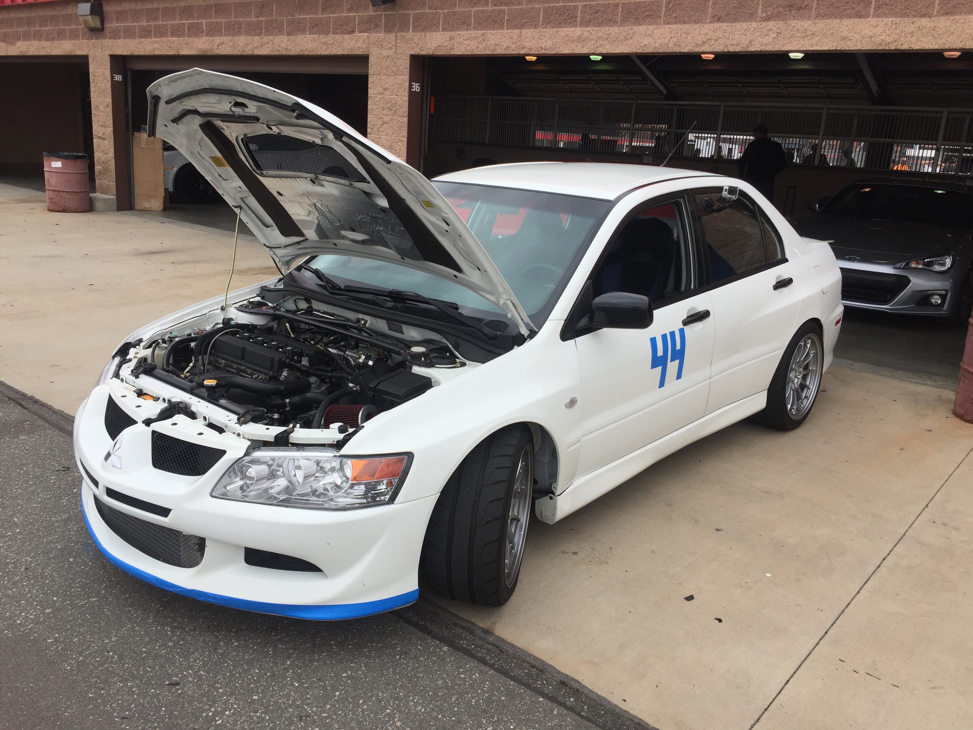

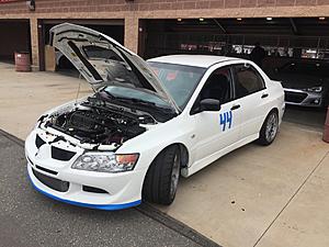

Oh and oil is redline 10w30 with about 50 miles on it. Normally I use a 20w50 weight oil but this is all I had available at the time.
Just before the carnage

Check the turbo for shaft play. I had a stock turbo go bad and make metal like that. Also the metal could be from balance shaft bearings, or the main bearings. You only have the rod bearings there. Those rod bearing def took a beating though. How does the crank look?
