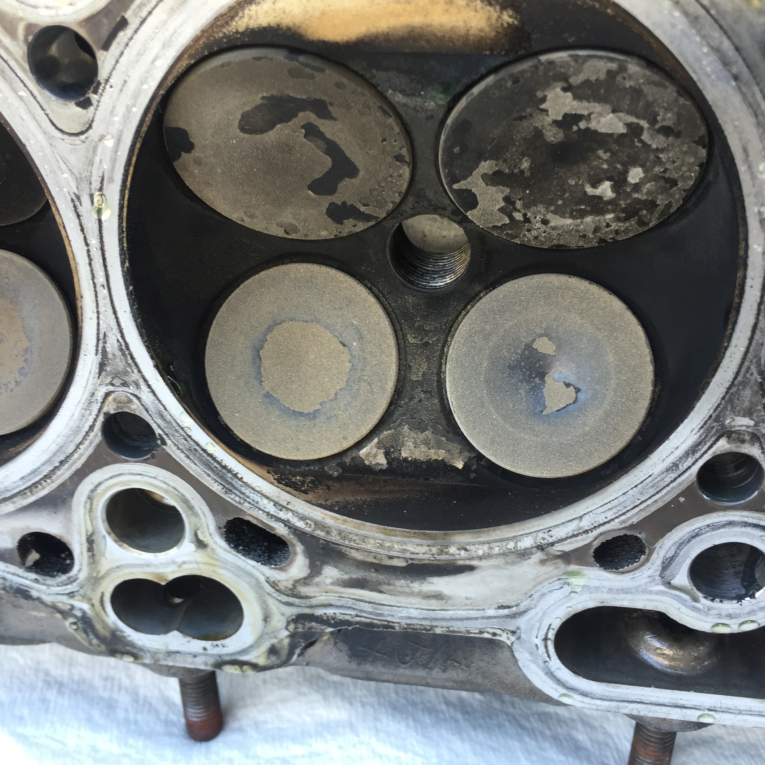

Pulled the head off and Pistons/rods out yesterday.

Valves look ok.

Head

Odd though. Exhaust valves and from manifold collector turbine o2 and down pipe are all light gray/white?

That's normal, those parts run hot enough, it burns the carbon white. Just like the hot parts of camp fire, the ashes are white not black.
