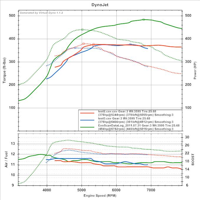

new numbers with e85 the 2 lower ones are de-tuned 91octane with only 23psi for safety at the track

Old Aug 4, 2011 | 02:06 AM
azndoc's Avatar
Joined: Jan 2011
Posts: 7
From: Los Angeles
Nice numbers
Old Aug 15, 2011 | 06:24 AM
BigT's Avatar
Posts: 1,029
From: NW NJ
I was hoping you could actually record a full pumpgas pull through VD. Do you have any logs where you started at say 3000rpm or lower?
