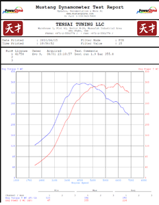

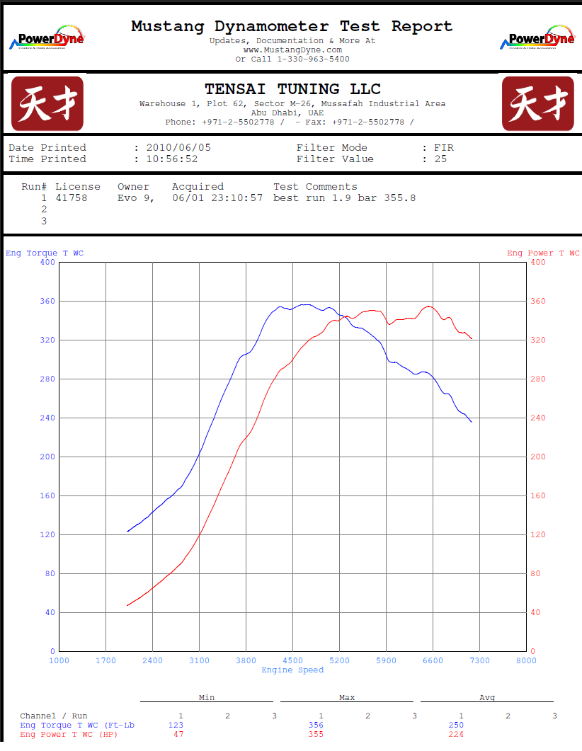

I sent my car for a tuner who gave me this result, 355WHP, and 356tq on his mustang dyno.. and Even though he claimed the car was set at 29psi as high boost, my greddy Profec EBC registered 2.2 bar (thats nearly 32psi).
As you all can see, the car has one of the all-time worst graphs!! On high boost, the car pulls hard b/w 4K-5K then feels like its on low boost all the way to 7500RPM.
He could not figure out whats wrong.. He claimed that it might be the wastegate or something hes not aware of!! I made a boost-leak test and the car isnt leaking..
In addition, it takes few seconds to start on cold-starts, but if its warm it responds rightaway.. Dont know if thats relevant or not!
Please let me know what is wrong if you've encountered such issue before.. Here, I'm attaching the graph along with the mods list.

Do you know if the dyno reads exceptionally low ? Has the dyno been calibrated lately ?
Assuming it is NOT the dyno, I would look for the most common culprit which is a boost leak. You say that the tuner and a friend "made a boost leak thing", so I am assuming they know how to properly test for leaks and that you don't have a leak. That said, I am still guessing you have a boost leak or your turbo is DOA.
Can you pressurize the system (up to the throttle body) and hold 30 psi ? I first like to make sure the major problem areas are fine, before I pressurize the intake manifold and test the injector seals.
Maybe Chad can look at your tune or logs and help identify the problem. Good luck
