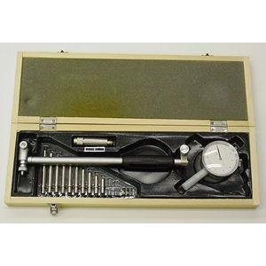

factory cranks from mitsi are not all exactly the same size.
there are different mains tunnel sizes too.
best way to do it is to correctly measure your crank, and the mains size with the head bolted on the torqued.
When i built mine, it was 3.6 thou for my mains, and 2.0thou for my big ends. I put in 1thou tighter bearings (not 1thou looser like we are talking about here) get get my mains to approx 2.4thou. This is still far larger gaps than factory, but i'm running 15W50 Motul.
It also goes with the rule of thumb - 1 thou bearing clearance per 1" of journal diameter.
To the OP (if you're still having problems) you need to find out why you're running bearings.
If it's happened 3 times, but your engines have been build perfectly each time, then you're just going to run into trouble again.
Which bearings are running? Number 4? (furtherest away from the oil pump)
p.s. when i was building my engine, i used precision tooling. Not plastigauge.
something like this
