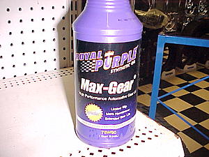

Ray: take that one out and put this one in and then let me know, you would be amazed.

I don't think they sell that here in Hong Kong. Did you try MT-90?

Join the club with a notchy shifter. I have changed my oil 3 times and now have red line in. Tried Royal Purple for 3 days and changed it out , the thing would harldy shift!

Almost forgot Royal Purple Max Gear, from there web site the marketing makes it sound wonderful. Hmmm I know I can get this at the local Napa.
