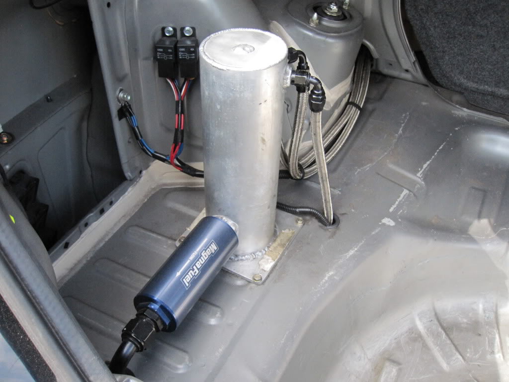

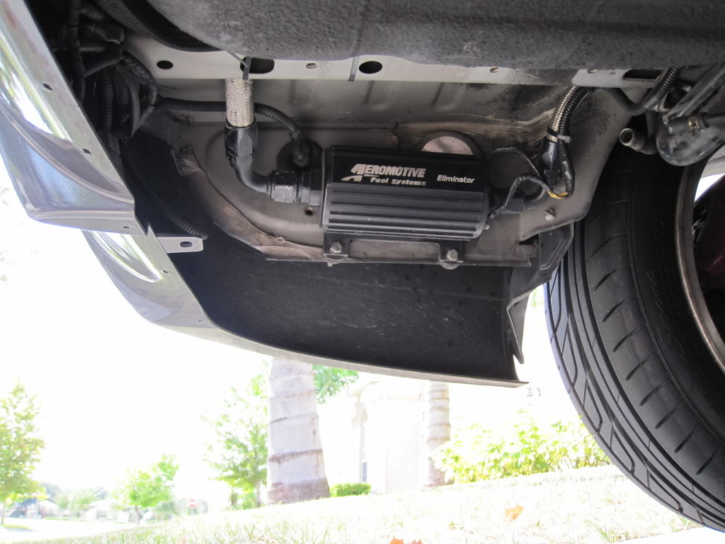

i ran a filter before the pump to make sure nothing goes threw and tears the pump up ..
Old Apr 23, 2011 | 08:56 AM

Thanks for the picture guys....
