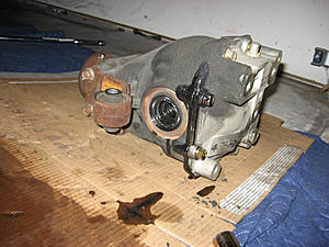

I took my rear diff apart so I can re-assemble the plates correctly--the way the service manual says. Upon taking it apart, it seems I've had a leak at the top of the diff for a while. There's black gunk all over it. Is this because it's got a bad gasket seal from factory? It's never been worked on before. Do I just need to make sure I do create a good gasket with RTV when I reassemble it?

Is it a tar like gunk? If so maybe its just the underbody rust proof coating.

Maybe. I'm not a very experienced mechanic to know how to tell the difference. It appears to be something oily with a lot of sand/grit accumulated.

The problem will be fixed as soon as you re-assemble it. There is no gasket it's all RTV.
