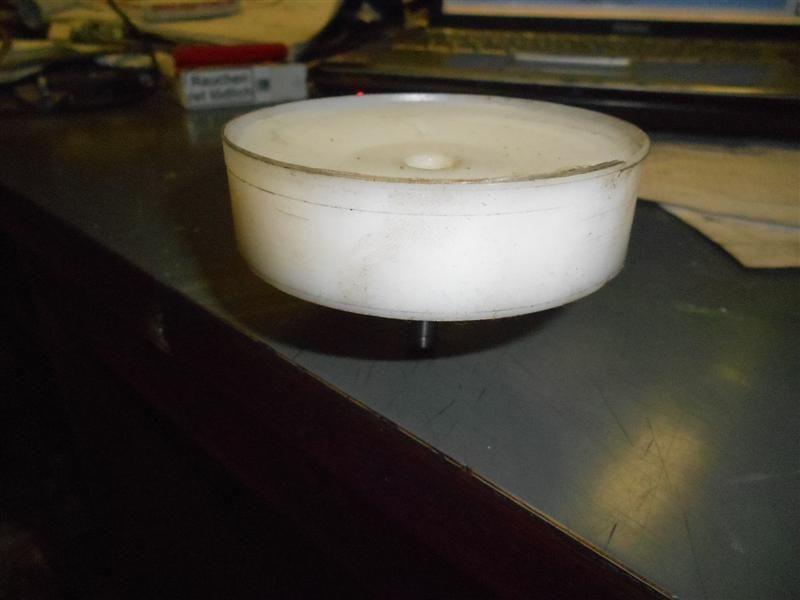

Its possible without any harm to hone the block with the crank installed and inside the car.
Its not an traditional Hone as many expect, its only to rough the surface and get rid of the glaze areas.
I built my own "plug" ...its sitting on top of the crank counterweights facing up , at the very lower end of the bore, sealed by an o-ring, and an flexible "upper" Lip. Its built from Teflon material, so its more or less pressed in. It has an drain in the middle like an funnel with an drain line, so cleaning is possible...
Picture of the first version, "Delrin" material later changed to Teflon for better seal to the walls and with o-ring.
Hone plug
Its used with an "Flexhone" type Honing tool.
http://2.bp.blogspot.com/-L7Bzqct23T...one_Diesel.JPG
Its not intended to remove Scratches....its only to give new rings an Surface to bed in...
Its also not possible to get an "out of round" liner back to spec, so no geometric change possible.
Any Real Damage to the walls will need an proper machine hone ( then the PTW clearance are out ) or an Bore/Hone job aka Full built

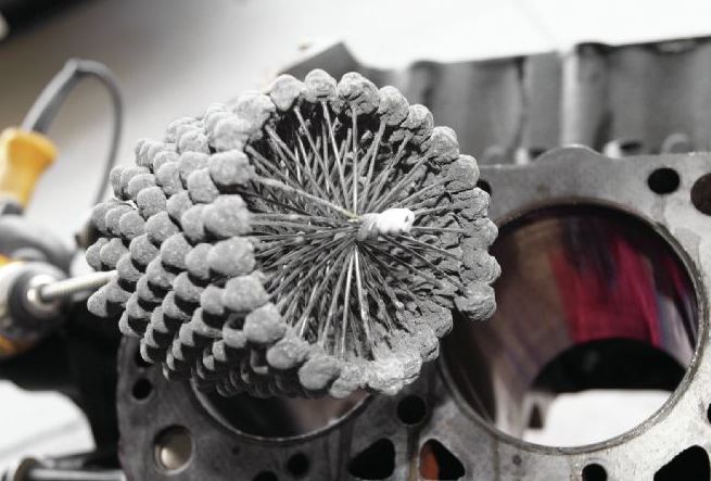

My engine was out of the car but the crank and balance shafts were still in the block when I did my drop ins. I honed the cylinder walls with a ball hone on a drill. Just have to be sure to wipe down everything very very liberally with brake clean, wd40, and oil a couple of times. Being thorough is key, take your time to ensure everything is clean.
I'm at a bit over 3k miles on my drop ins and the engine has consumed pretty much no oil. That's also largely in part though because my out of round and taper in every bore was under .001".

A power hone always gets the angle right because the up and down stroke of the hone is geared to the rotation of it.
A hand drill with a ball hone will ALWAYS be wrong.
A ball hone on a drill will always be better than no hone. If you're using a ball hone to the extent that you can wear all of the way through the original crosshatch you shouldn't be touching an engine. By the way, I'm at over 4k miles on my ball honed drop in build. Doesn't consume any oil, no blowby issues either.
