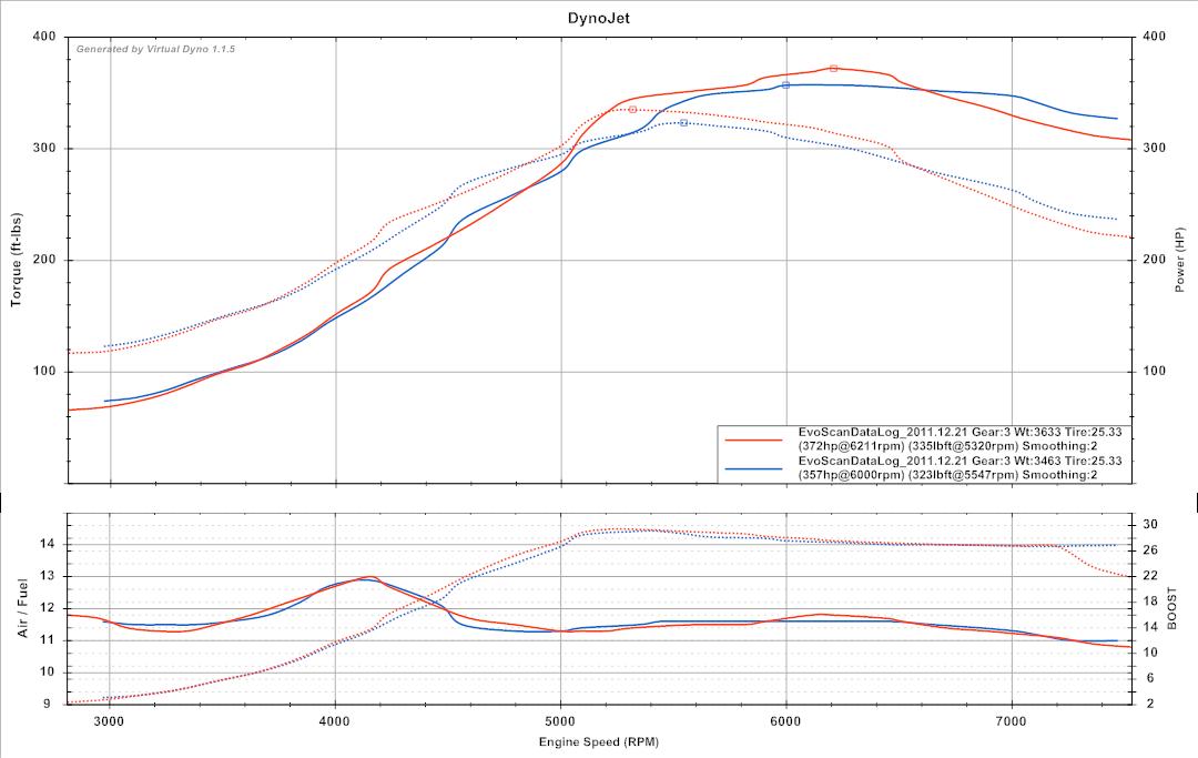

Long story short...Recently bought an evo 8, the car was on a conservative tune and had some issues so I decided to get it retuned. Made 403whp 343wtq on stock cams 93oct. Decided to get HKS 272's since car is a DD I figured this would get me to my goal of 450whp. Well after installing the cams car is not making hardly any power.

Any Suggestions on what to troubleshoot would be appreciated. Graph is attached.

Was the car re-tuned after the cams were installed? How much boost are you running?

yes we are trying to retune but can't get more power than what the graph shows boost is 27psi.

It could be off timing ..

cams were installed wrong, you're off a tooth

Thanks guys...Checking for timing tomorrow.

Right on the money....2 teeth off

I figured with the turbo spooling up 1500rpm late...

Stupid question. How did you know full spool was 1500rpm late from the graph? peak rpms?

No, look at the boost profile... and when it is hitting full boost...
