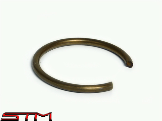

man is there like a picture or manual of this c clip you are all talking about? lol

If someone hasn't posted one by this evening, I'll post a picture. I've got my transmission out right now, but I'm stuck at work for another 6.5 hours. Off the top of my head, it's on the shaft that comes out of the transfer case (passenger side). The axle has a female end that clicks onto the clip of the male shaft (sticking out of the transfer case).

Thats the c-clip at the end of the axle. Locks into the front diff.
Its #3 in this diagram ^.

thanks for the picture. but man, i really have no idea whats causing the vibration now. if the axle is supposed to move around like it does in the video, there shouldnt be a problem with the axle really. its not leaking any fluid...... i have no idea what to look for now..
