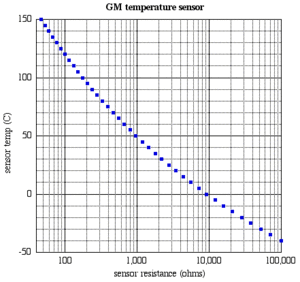

The water temp sensor uses the same sensor wire as the IAT sensor, and both are good up to 150C. The main difference is a sealed sensor for water vs an exposed sensor for air. A plot of the calibration data I put together on the IAT sensor is below. My MAT logging patch includes this calibration data, so once you've got the sensor wired into the fuel tank temperature circuit on the ECU, you're just one patch away from logging gearbox oil temperature.
I have purchased the above sensor some time ago but haven't found a place that had a good way to install it inline. Let me know if any of you have ideas. The sensor is a bit large which makes it difficult to place inline without obstructing flow too much.
