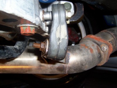

in some previous posts i discussed the o2 sensor bung from the ultimate racing test pipe rubbin driveshaft when it was WET out. Well here in the northeast we got hit with SNOW/RAIN/SLEET..basically complete mush. well on the way home tonight from work the rubbin got REALLY bad...i mean really bad. Then all of sudden....o2 sensor code. P138 and P141. So i assume from the constant hittin the driveshaft. So i look under the car tonight i seems like the entire exhaust is alot closer to the driveshaft than normal. And it also looks like the exhaust is not straight.

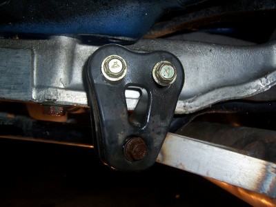

more

Did you run over any big piles of snow or anything like that? It does look like it is pulling on the exhaust hangers. Disco the negative and reset the ecu, it should go away. unless the 02 sensor is damaged from the banging around . Do you see or feel any dents in the exhaust ? Hard to make out in the first pic.

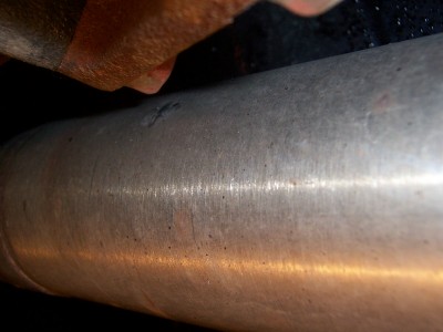

more

Ah you can see the gash ,well sratch where it was hitting. That is a close fitment . Im running kartboys exhaust hangers, I would highly recommend them. They will keep your ehxaust very tight . My buschur turboback had some rattles till I did this and now I dont hear a things. Have you tried to reset the ecu now that you know what the codes are?
