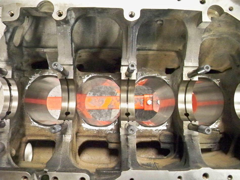

I had the same issue when i was building my 2.4LR with my Turbo Tuff I-beam rods,usually H-beam rods don't have this issue since they are thinner,most manufacturers recommend a minimum of 0.060"clearance between the connecting rods and the block,what i did was o made a 6" strip that was 0.065" thick to wedge in there like a feeler gauge and make sure i had proper clearance,also the rib with the arrow on it needs to be shaved down.this is how my block ended up,runs great
Thanks for the picture and why does that little rib there need to be shaved down? I also see that you don't have any oil squirters as well. Have you had any issues with your motor and do you track or drag your car? I was planing on getting a AMS wet sump oil pain as I will be doing some auto cross and time attack in mine.
Once you notch the bottom of the cylinders and the crank can spin freely the rod will hit that rib also,so it will need to be grounded down too,the car has 20 drag passes so far, aftermarket forged pistons are not set up to take advantage of oil squirters that's why stock pistons have those weird holes in the bottom of them,my 2.4 block didn't have them so i didn't think i needed to spend the extra cash just to have them splash the bottom of the pistons,no issues so far.
I will be having it done soon and thanks about the tip of that rib. I was not aware of that, but thanks to for the info. I decided to not do the oil squirters as well since it doesn't seem like they are a big issue. Glade to hear yours is doing good as your push it and don't have any issue so far
