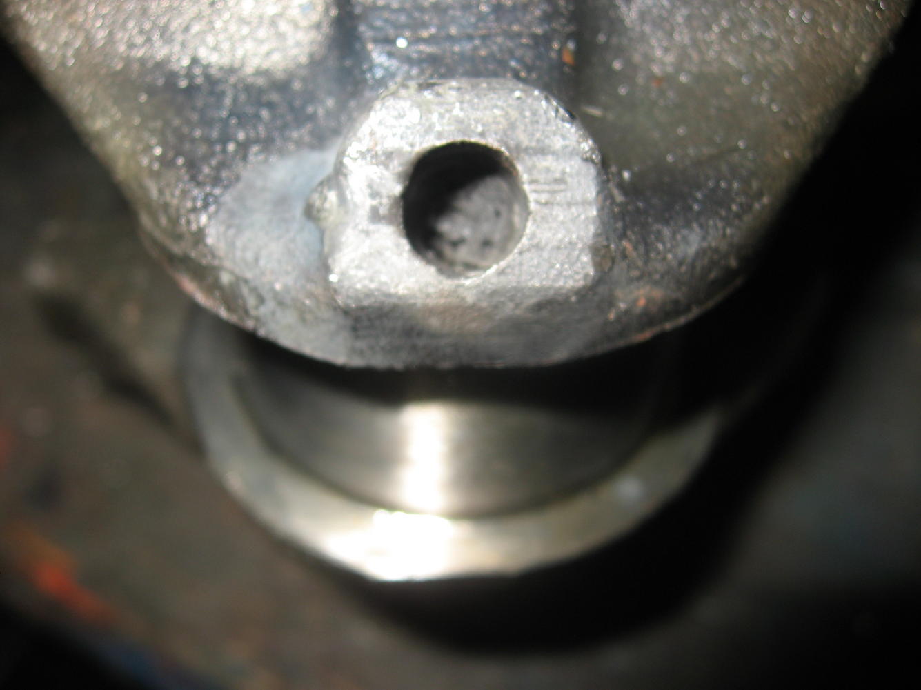

Well, personally, I have installed three .010/.010 cranks in 4g63 engines, 1 6 bolt, and 2 7 bolts.
All running 350+ HP one over 400 the last I heard. No issues with the cranks, But I do pay extra to have then gound at a slower rate, so not to weaken the hardning of the crank.
There is no reason for a crank to "eat bearings if the harding of the crank has not been compromised.
Also the same belt used to polish a crank, is the same belt used to polish a crank after it is ground.
One way a crank might eat bearings is if the crank was ground or polished in the wrong direction.
The mico fractures of the crank will face the wrong way and want to dig into the bearing.
Another reason rod bearings get chewed is an improperly cleaned crank.
The rod throws are of a crossed drilled design,with an intersecting oil galley to the main. Thats the reason for the ***** pressed into the side of the rod throws.
There is a dead space from the edge of the rod bearing oil galley,to the outer edge of the rod throw. appox .225 Dia X .750 long,
Now over the years, since oil does not flow, it get packed with crud, now on a rebuild, The DIYer will run break clean in there to try to clean it, and it will to a point.
A machine shop will put it in a spray cabinet,or hot tank.
All 3 of these methods will get some but not all of it. But all 3 methods will start to break down the crud.
Now intall the crank, prime the engine, start the engine and go drive, now the soften crud goes straight into the rod bearing.
Now if the crank was ground, having a ground crank will be the blame.
Also keep in mind when the crank was ground, metal from the crank along with grit from the crank grinding stone, and abrasive from the crank polishing belt all went through the main oil galley, and the cross drilled oil galley of the rod.
Now what is standard procedure with me, is to remove the press fit oil galley ***** in the crank, and remove the crud build up.
Is this crud build up just common to the 4G63 crank? No it is not, Nissian RB26DETT, Mazda 1.8BP are a couple others I found with this issue.
I have noticed some of the big aftermarket crank grinders that supply crank kits to auto parts stores have been removing them also.

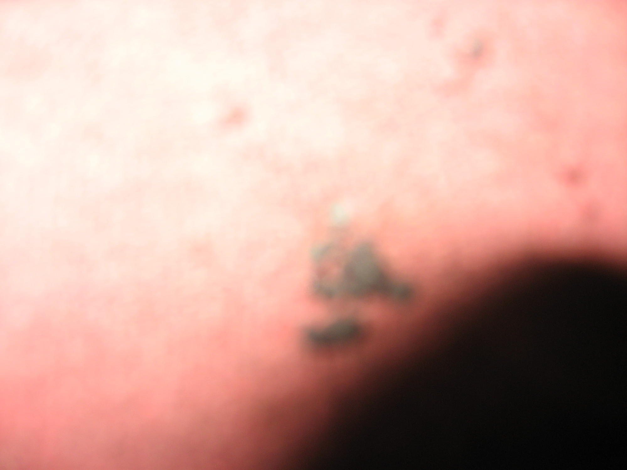

I have spoke with another well known 4g63 Engine builder, and they do build engines in the 500+ HP range. They have no issue using a properly cleaned and ground crank.
Can you tell me another engine that "eats bearings" when the crank is ground?
The crud I remove from behind the oil galley ball in the rod throw of a 4g63 Crank.
