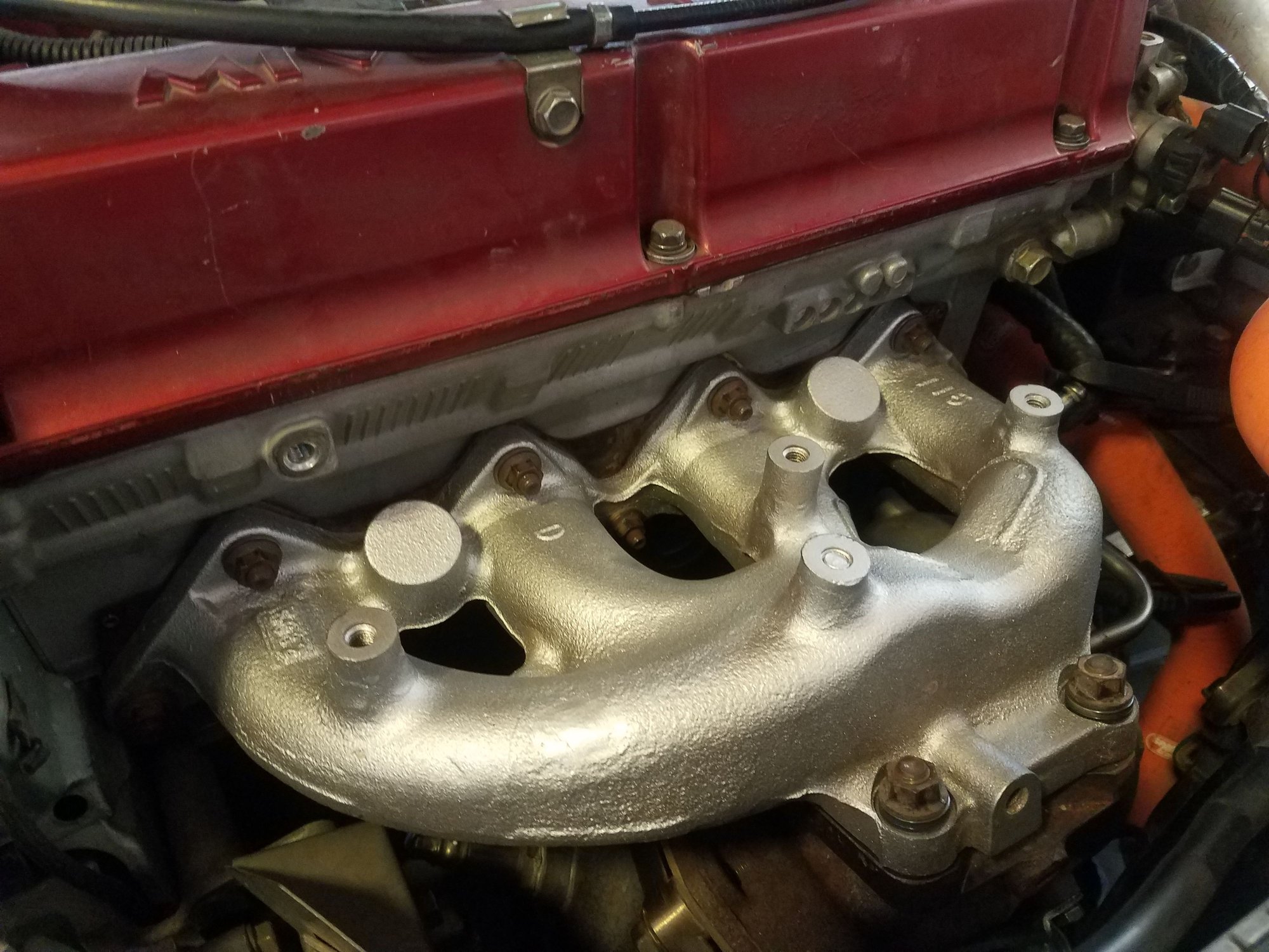

I have an iron manifold. So far, so good This is after two years of autox and track use. I gave my turbine housing the same treatment.
