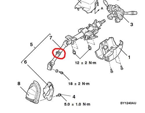

Inspect the intermediate steering shaft. I had the same problem when the subframe was lowered to remove the transfer case. The mechanic separated the shaft (as circled red in the attached pic) and reassembled the two halves with the wrong orientation.
I had the same heavy, light, heavy feel. Flushed and bled the PS system thinking the fluid was the problem. I changed the orientation of the shaft as pictured in the manual/attached and problem solved.
