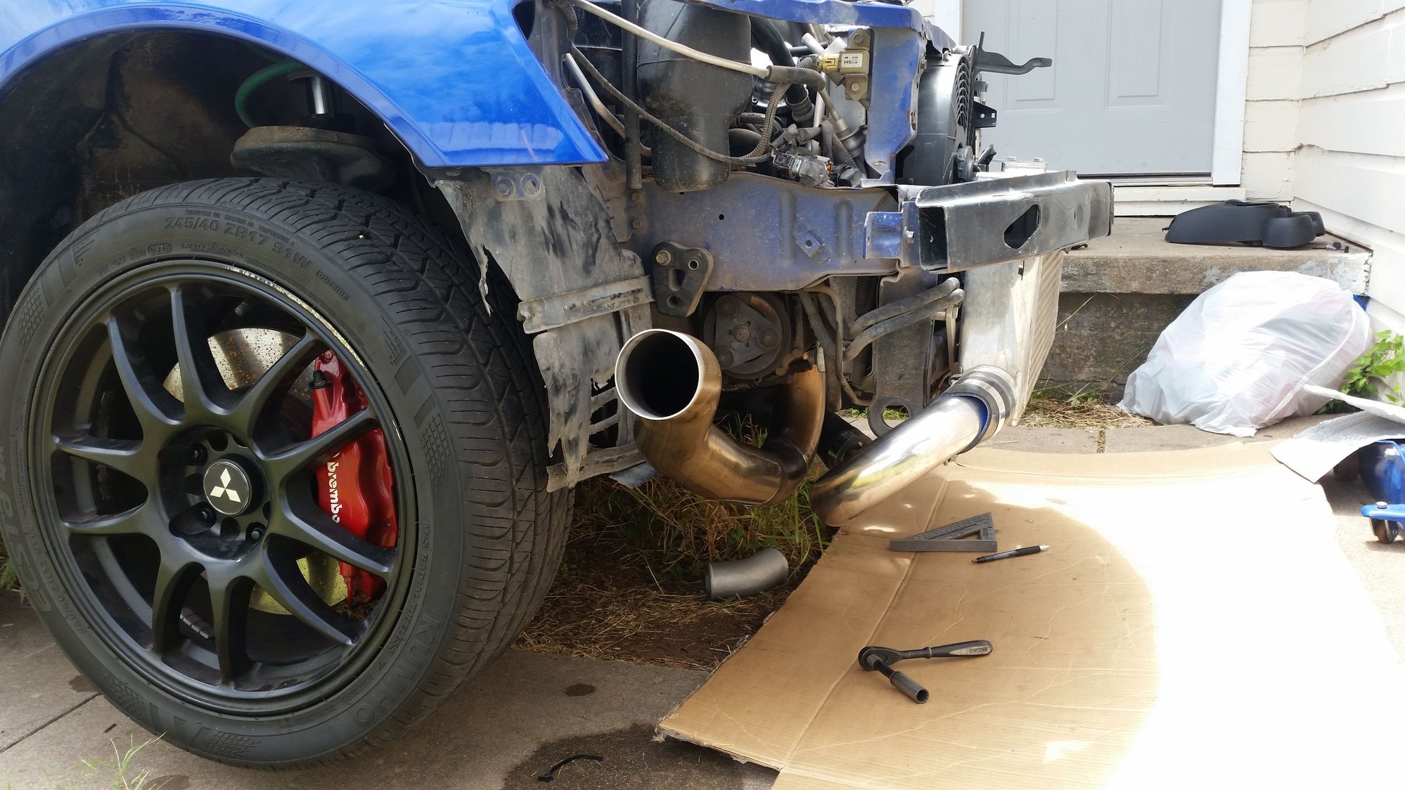

I just deleted yesterday.

True. Thats why i pulled the oil stat also

If you just daily driving or in traffic it does nothing for you now if you're doing autocross then yeah you'll need it just depends on what you use your car for

Not the moral in mine

Now with that out of the way...

For a drag setup, Yes. For a DD, absolutely not
