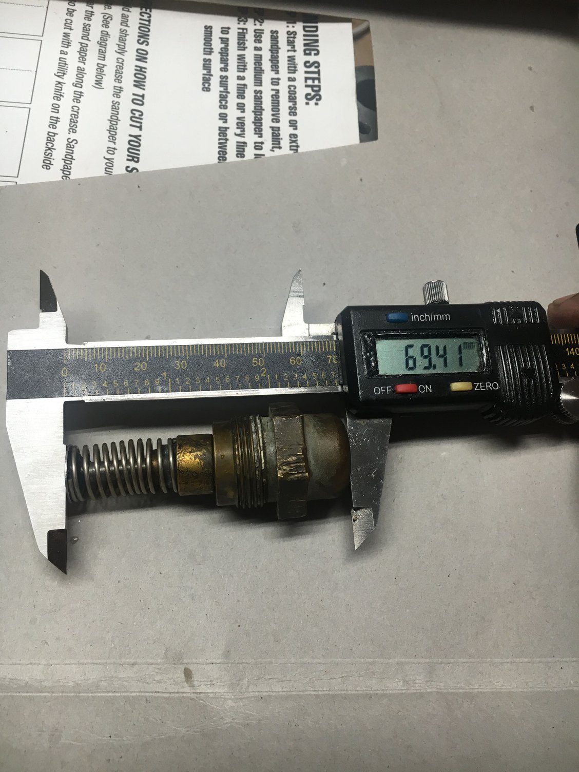

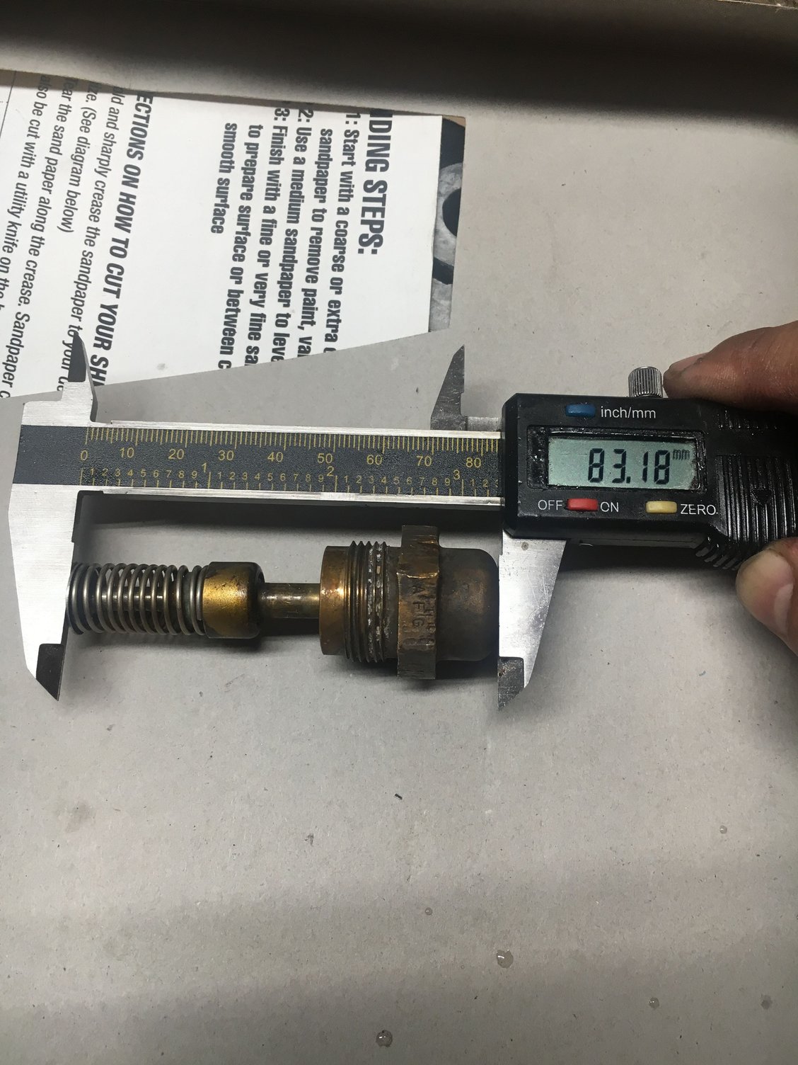

I don't post a lot on here but I read a lot of the posts. This is one of those posts that make me questioned well known shops and their knowledge of 4g63t.
These pictures shows the thermo valve before and after boiled in water. You got to be crazy to not chop that springs out when plugging the oil cooler lines.
