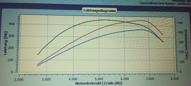

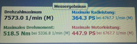

yes, but it`s a little bit more complicated. I live in Germany, Dynos here show HP@crank, the problem is our dynos are measuring the power on the wheels for sure but this measured power will be affected by the fastening on the Dyno, if the car is strapped down with much force on the rollers the measured WHP will show a lot lower results, but this is compensated by the drivetrain loss measurement on the roll out phase. Normally I see about 100HP difference on a 500hp@crank EVO to the wheels (about 20-25% drivetrain loss).
the only rollers I know which show not much difference in whp to crank-hp are dynojets, but no AWD Dynojets in my region.
the other thing what I have seen so many times is that setups which do some decent whp numbers on US Forums are normally here the same numbers at crank with exactly the same parts and the same tuner.
so if I think about my evo should do about 550-600whp, I roughly estimate about 580-630hp@crank here.
in other words ;-)
this are my FP GREEN results at 30PSI down to 27PSI at Redline
so I need additional 100-180 hp at crank to be happy with my new setup.
I also orderes some Alcohol injection for some more octane ;-)
