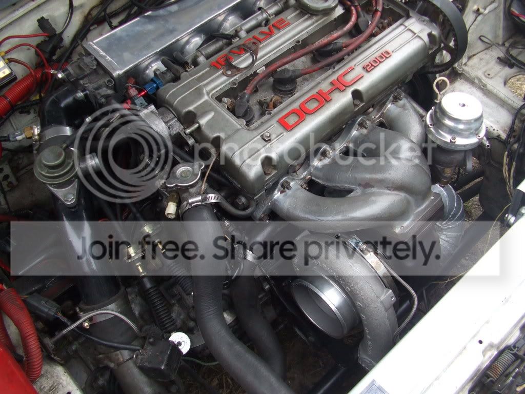

What twinscroll cast manifold are you going with? I'm looking for a manifold solution to EFR my GVR4.

I have an OnGreenPerformance manifold, it's probably 15 years old. It's actually a replica of an HKS manifold made for Galant VR4s, but with minor changes, notably the fact that the whole turbo flange is divided and the wastegate flange clocked. The HKS kit had an O-trim T67 on-center turbo (or something), wastegate, downpipe with integrated wastegate dump, etc. I just need to have the wastegate port divided to the flange and then blocked off. It sure puts the turbo far from the block, which is worrying, but nothing that chopping up a rad support won't fix. At least there's lots of room for oil and coolant lines in there The odds of finding another are pretty slim due to the age, and there weren't many made to start with.
