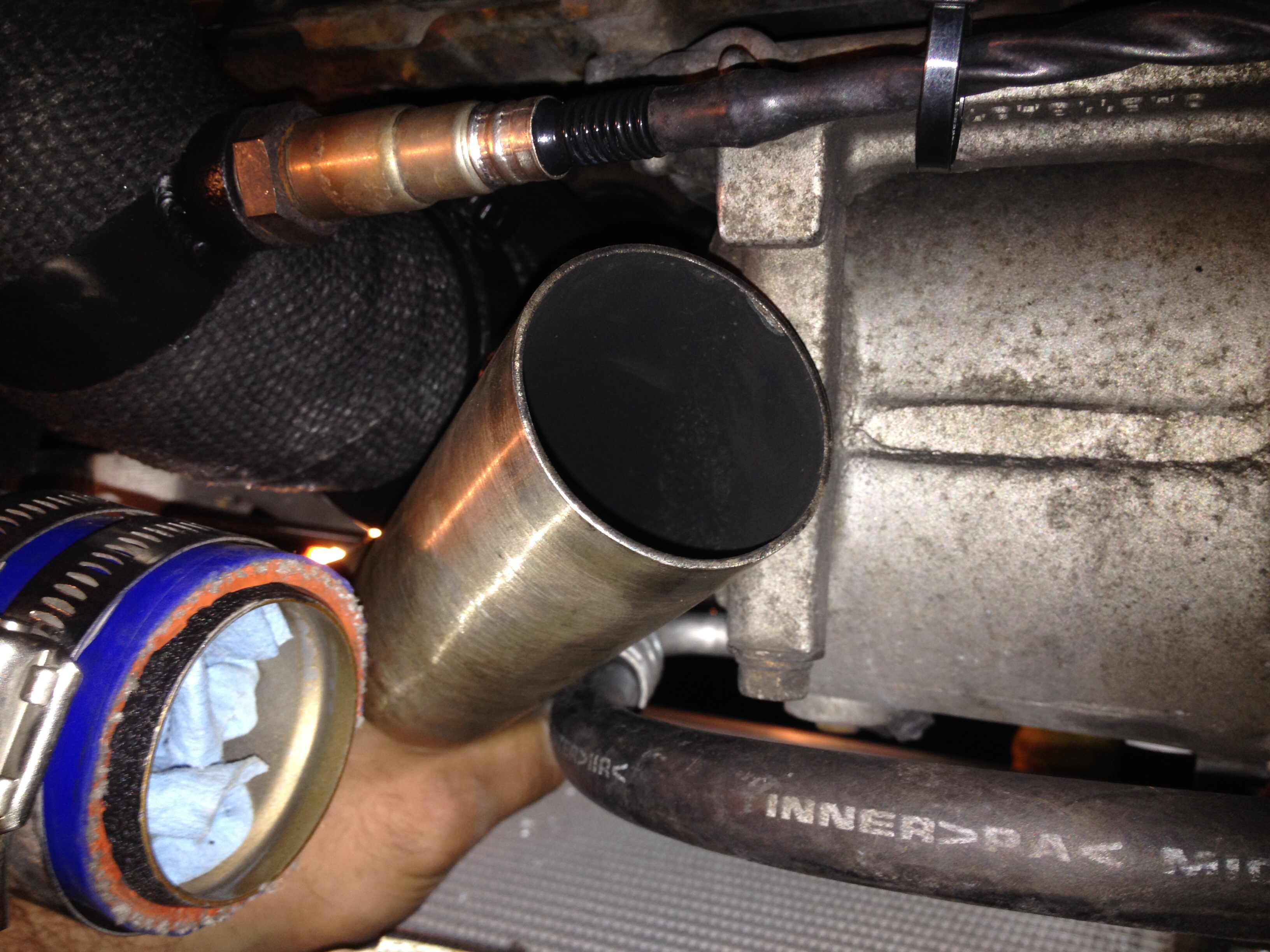

Well I got an angle grinder, put a cutting wheel on it, and went to town on this mother****er...cut the dump off and angled it a bit and it seems to work...ill wrap it as well...when I finally had it the way I wanted it I realized the ****ing wideband goes right there where the dump is...gotta move the bung back so it'll work...also gonna try and put a bend at the end so it shoots the fumes to the ground...I'll update it tomorrow when everything is welded and installed hopefully...i almost routed it towards the other side under the starter but realized my radiator was out of the car lol no wonder there was a lot of space...

That looks like a Buschur LICP setup. Put a stock Jpipe on it and an ETS or muse licp and be done with it.

nope...too late i already cut the o2 dump...taking it to get welded tomorrow...itll be an easy $200 for stock j pipe and muse licp...ets licp is $200...no point when i can just fix this setup...

I'm not hacking anything up...I cut it at the weld and it will be welded in the same place...all it needed was to be clocked to the side a bit...I'll had .5" to the j pipe this way it'll sit a little lower a d ic pipe I can clock it down a bit too...guys this is done all the time...how do you think these companies develop these? I'm doing this so it works on my car...it's gonna look as good as new...I'll post pics...
