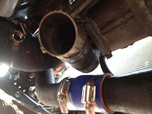

here you go guys...who's says muse o2 dump doesn't work with buschur pipes...for those of you who prefer spending $300 instead of making **** work...cost me $60...coupler will get upgraded to a high heat coupler but in the mean time it'll be wrapped with heat protectant wrap...didn't feel like cutting up the pipes a whole bunch...oh, dump was extended 2" and added somewhat of a 90 degree bend at the end so it points the fumes towards the ground...there's a good 1" - 1.25" between dump and pipe...some times with a little bit of time and patience you can make **** work...you don't always have to go and spend a million $ for a freaking pipe...oh btw, I bought this dump for $100, bought copper gasket for $40 (wanted best gasket didn't have to go this route), and spent $60 making it work...$200...

$40 for a gasket? Why didn't you just use the stock one and then use copper gasket spray? That stuff has always worked wonders for me on all my cars, just my two cents though.

i got the o2 dump used and didnt come with a gasket...i agree with the copper spray stuff, i use it alot too...all i could find was a steel gasket and didnt want that...figured id just get the copper gasket and do it one time...

Yeah I suppose if you're buying the gasket anyways might as well get the copper one. I had a smilier situation with my STM O2 dump pipe touching my stock LICPing. I just ignored it thinking it wouldn't get hot enough to do anything, but it ended up burning it really good lol. I just took the DP off and wrapped the whole thing and it hasn't gotten any worse. Next mod is the LICP before that one blows though lol

lol yeah...I got some insulating wrap and wrapped the o2 cables on it and that coupler under o2 dump...should be good......
