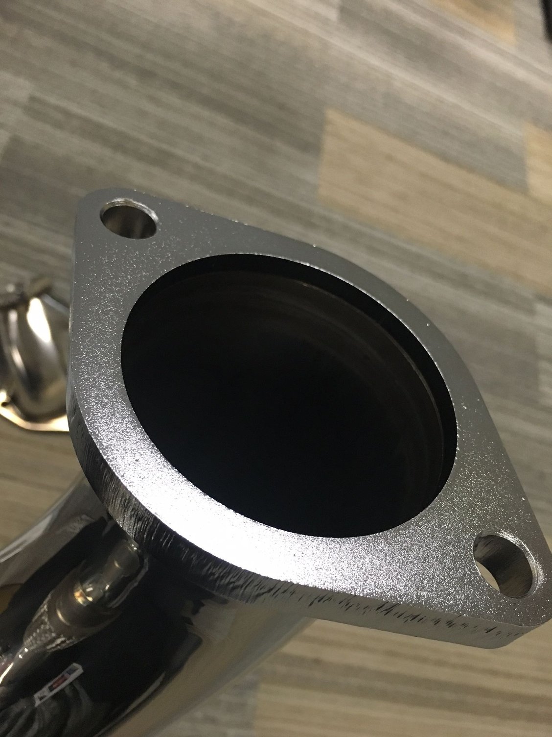

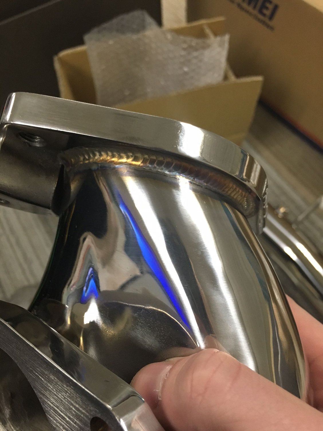

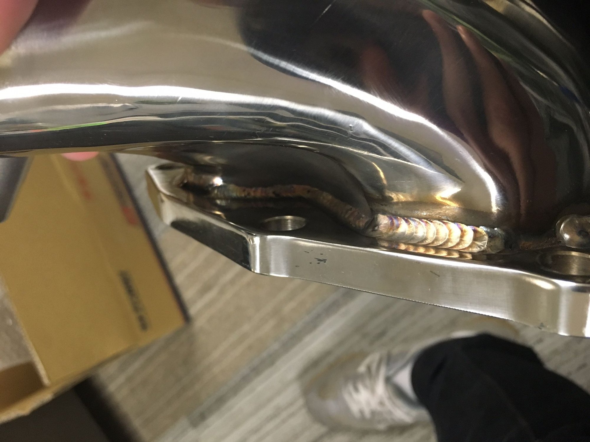

As promised, here are the pictures of the v2. All the welds look great, and they did some finishing work with a grinder on the inside of the welds. Great looking piece!
