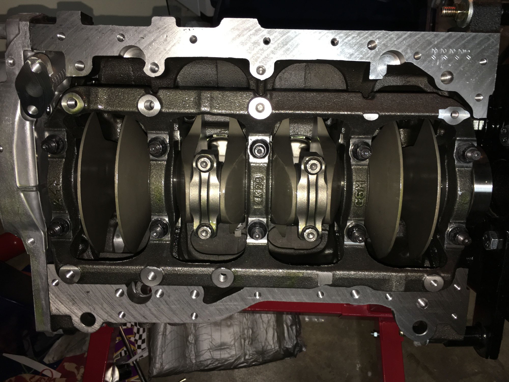

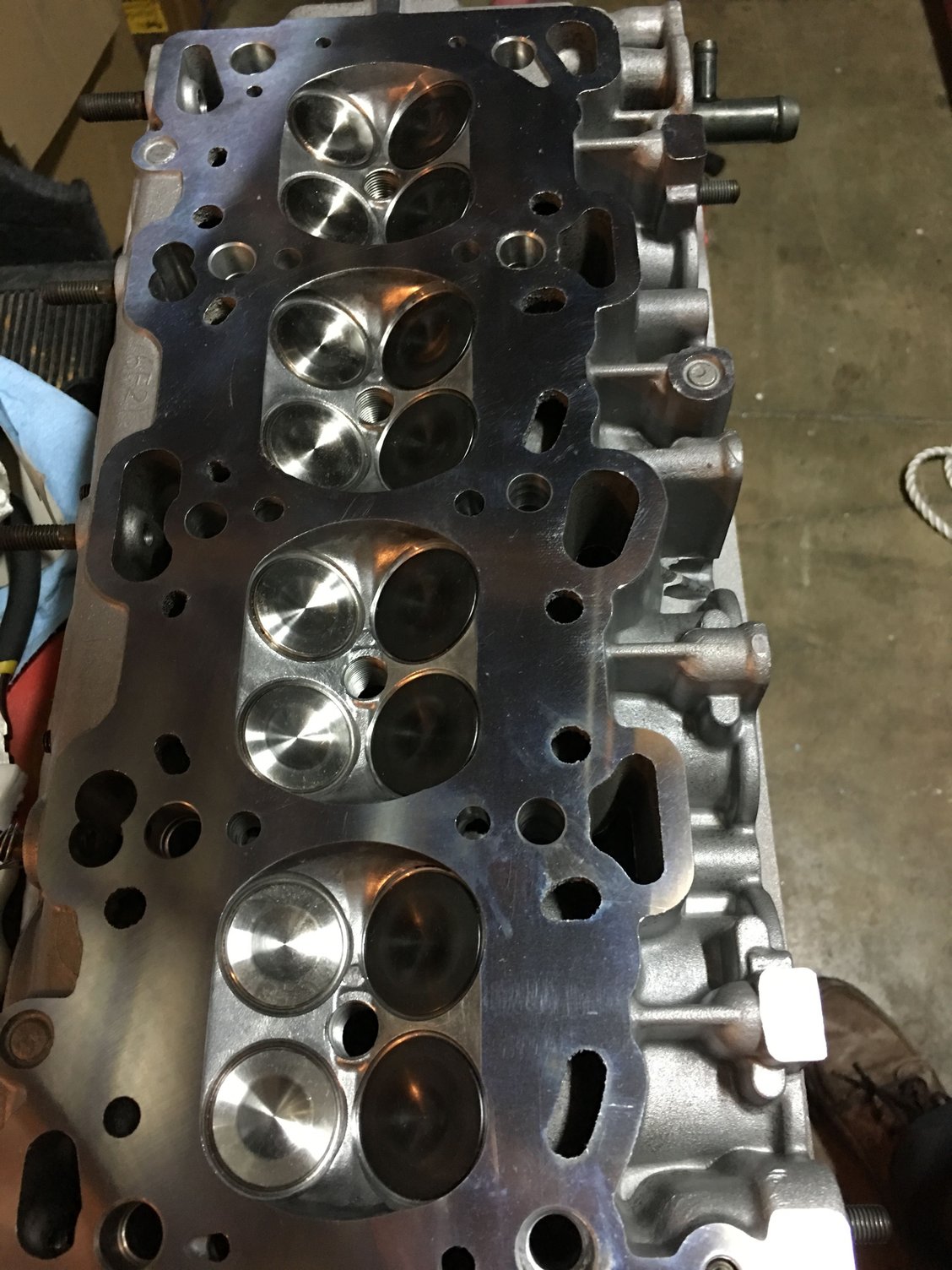

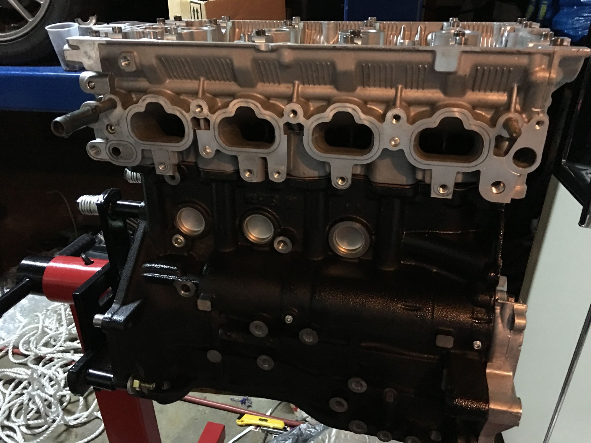

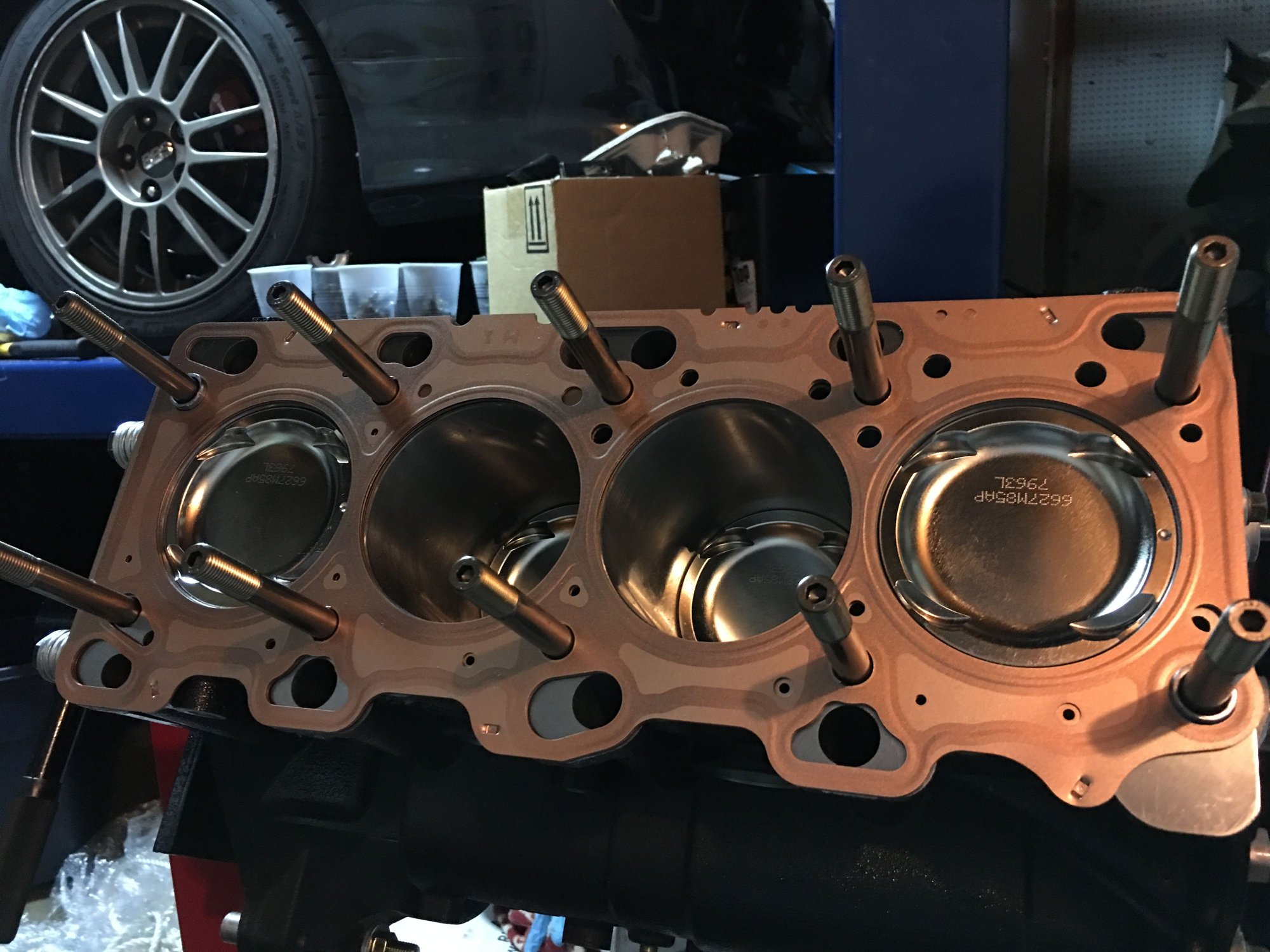

Hi all,
Finally found some time to spend on the build. Since I last posted, I've had my old head cleaned, machined for flatness, installed new Inconel exhaust valves, stainless intake valves, new bronze guides, new seals, 5 angle valve job, and pressure tested.
I finally bolted the engine and head together today with new L19 ARP studs. Some pics so far:
