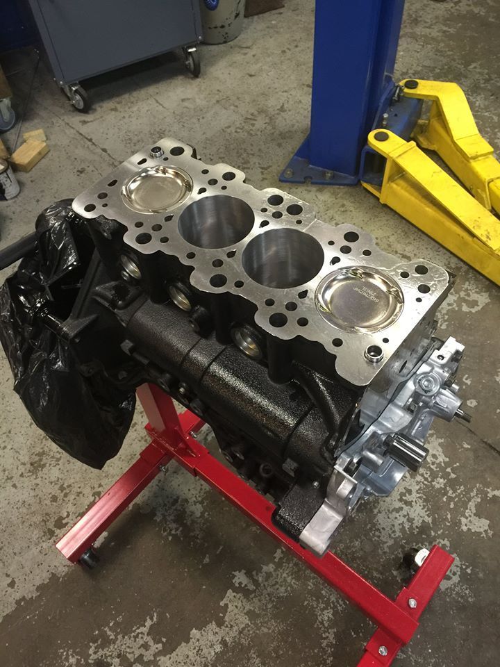

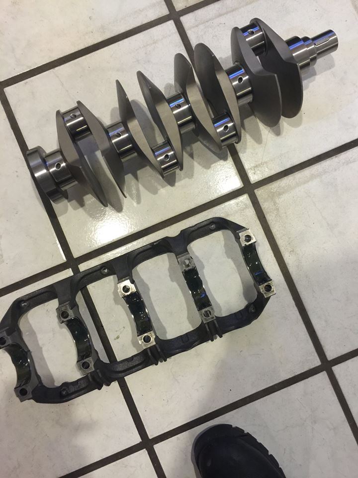

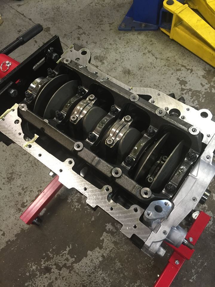

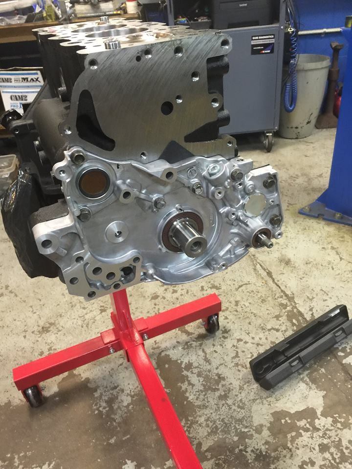

Hi all,
I got my 2.3L short block last week, built by tscomptuned! Here are some pics:
Specs are:
- Brand new block from Mitsubishi (zero miles!)
- Manley billet crank
- Wiseco 1400HD pistons/rings
- Manley turbo-tuff I-beam rods
- ARP rod bolts
- ACL race bearings
- New frontcase with balance shaft deleted
Working on the head stuff now.. Will post up images when I figure out what I'm gonna do. For turbo, I'm most likely going with FP Green (84mm FAP, stainless steel, Tial MV-S WG, FP "bigger than stock" log manifold, STM downpipe/O2 housing)... I hate that the FP Green SS isn't "drop in", but I can't find anything else 100% stock frame with similar spool and power capabilities.
Thanks!
