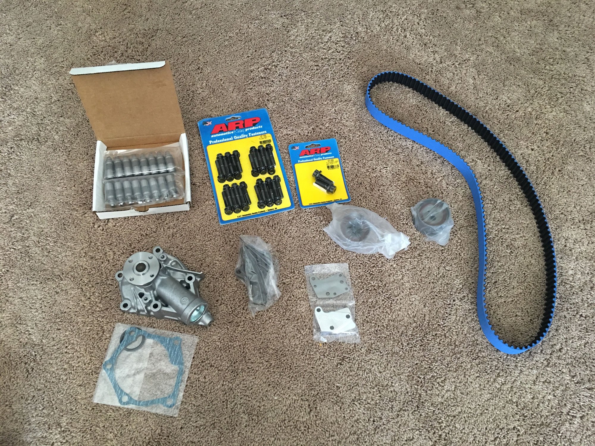

Ahh, cool - good to know! Some more goodies arrived today..
Brand new lifters (I went with the GSC Zero-Tick ones), Kiggly HLA, ARP bolts (I know the cam caps ones are overkill, but there is so much ARP on this build already, I thought I may as well keep it going! I like the 12-point heads anyway.), and the OEM stuff for the timing belt change.
Got more stuff coming tomorrow - so hopefully I'll be able to complete the long block build this weekend, including intake manifold, etc.
