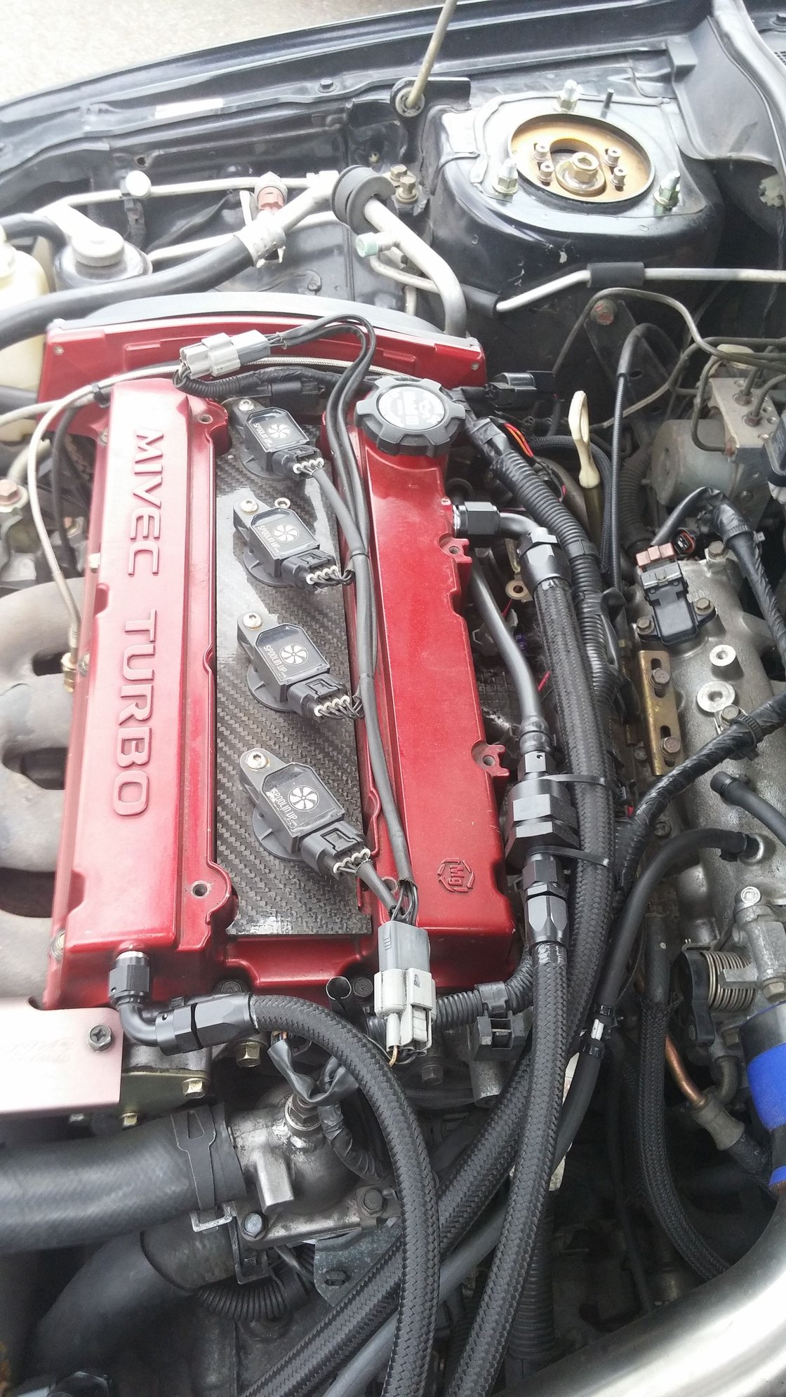

Old Apr 12, 2016 | 12:32 PM
  #51
bboypuertoroc's Avatar
Veteran: Army
Joined: May 2005
Posts: 2,046
Likes: 76
From: Riverview, FL
You can see both fittings off the valve cover (-10 where the PCV used to be, -6 on the driver side) and the valve/line leading to the intake manifold where the PCV used to go.
Hard to get a good pic with the intake on, but the lines/fittings butt up against the fan control module with the stock fan in.
