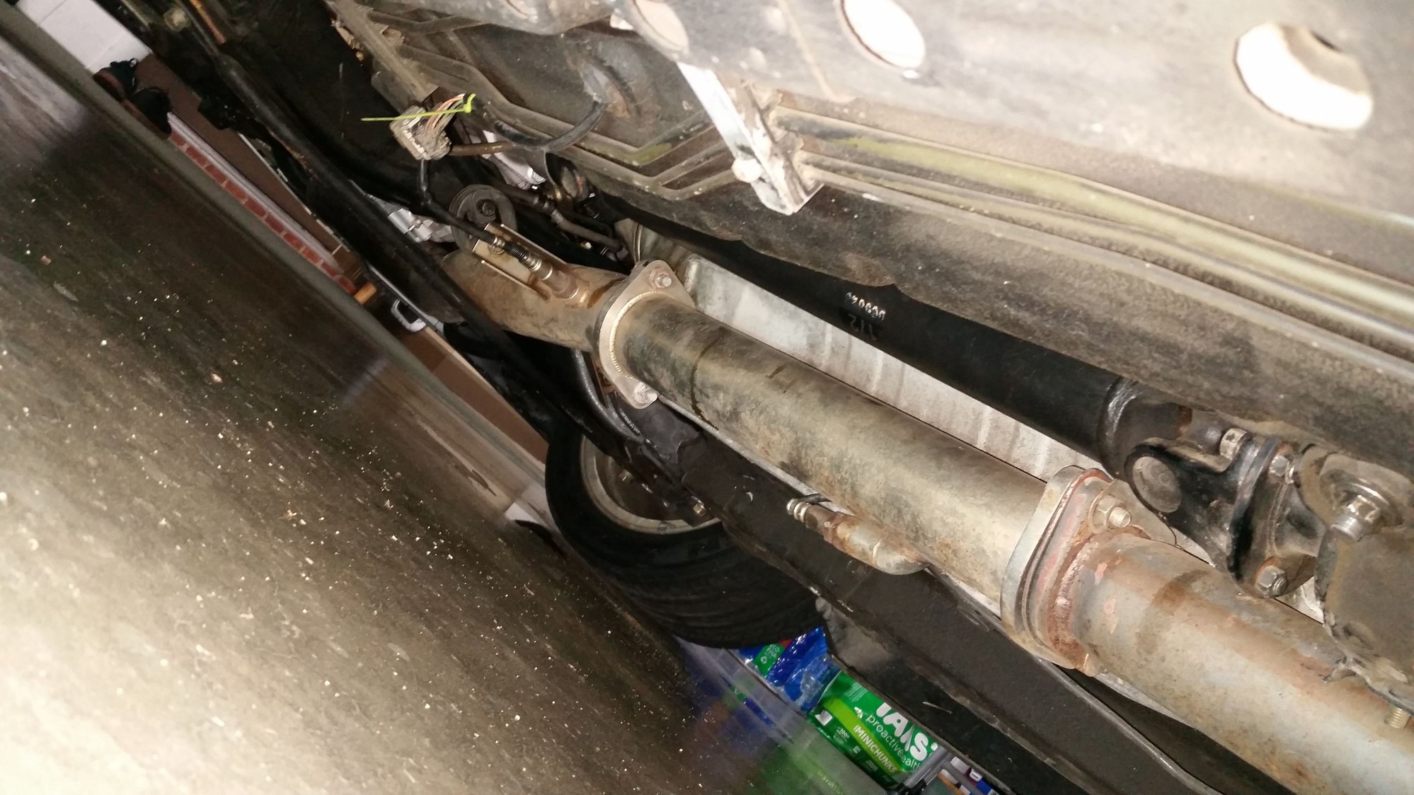

wanted to get an answer about my location for where the air/fuel gauge is reading, its right before test pipe.
Am I getting correct readings from here? I heard is should be top of downpipe right after header.
Here<br/>

mine is a little after the O2 housing to the side.

You should be fine. You want to read mixture not temperature.
I think you made some confusion with EGT gauges whose probes must be as close as possible to the exhaust ports to get actual readings.
