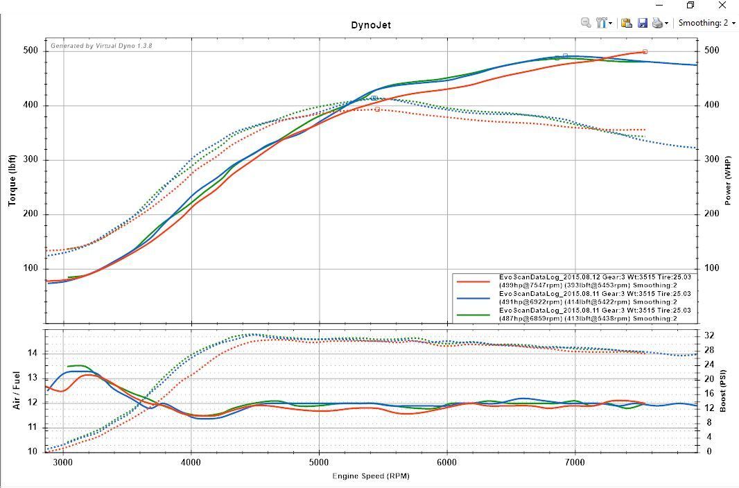

My 500hp chart is a VD but it has been on a mustang dyno on E30 and put down 415whp which is right what I expected based on the VD graph. I plan to get it on a mustang again next summer on E85 and it should make right around 460-470, which would be pretty close to 500 on a DynoJet.

Do you have a graph posted anywhere?
Interested wether I have to get rid of these 1120's or not ��
Something isn't right.

I don't currently have one posted anywhere. I will try to remember to post one up here tonight when I get home.

Here is a collection of virtual dyno runs I have done on my current tune. 2 were during tuning and 1 was a year later after I pulled the car out of storage.
