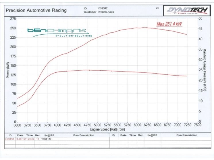

I've attached my dyno sheet, you can see it runs boost to 25psi at 4k. Will this be easy to replicate on the EBC? I'm not sure what to do just yet but I'm a quick learner so I'll do heaps of reading up first. Just wanted to make sure it doesn't need to be dyno'd to adjust boost properly
