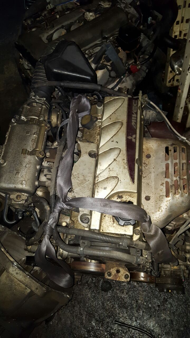

I'm trying to find a used 4G64, I found this engine. Did any of the 4G64 models come with a Mivec head & E-Throttle?!

Old Aug 29, 2016 | 12:46 PM
cerevo's Avatar
Joined: Jul 2011
Posts: 497
Likes: 12
From: Kentucky
Good question, can you tell if it has a timing belt or chain?
Old Aug 29, 2016 | 01:10 PM
foxbat's Avatar
Joined: Oct 2009
Posts: 926
Likes: 15
From: UAE
Not yet, I'll check it tomorrow, is should be a belt...correct?
Old Aug 29, 2016 | 01:15 PM
cerevo's Avatar
Joined: Jul 2011
Posts: 497
Likes: 12
From: Kentucky
http://www.club3g.com/forum/3g-eclip...-old-4g64.html
I would think so. I dont know if the newest ones use a timing chain like the evo X or not. I think they do.
Old Aug 30, 2016 | 01:16 AM
foxbat's Avatar
Joined: Oct 2009
Posts: 926
Likes: 15
From: UAE
Confirmed, it's a belt.
Old Sep 2, 2016 | 05:39 AM
foxbat's Avatar
Joined: Oct 2009
Posts: 926
Likes: 15
From: UAE
This engine turned to be a 4G69 not a 4G64, would this block work? I already ordered a BC 4G64 stroker kit & new 4G63 parts for the build such as the timing belt, head gasket, oil pump.....etc
Old Sep 2, 2016 | 06:03 AM
kikiturbo's Avatar
Joined: Mar 2008
Posts: 2,110
Likes: 320
From: Croatia
not really as 4g69 runs same deck height as 4g63.. for 4g64 specific build that runs longer rods than 4g63 you need a g64 block..
