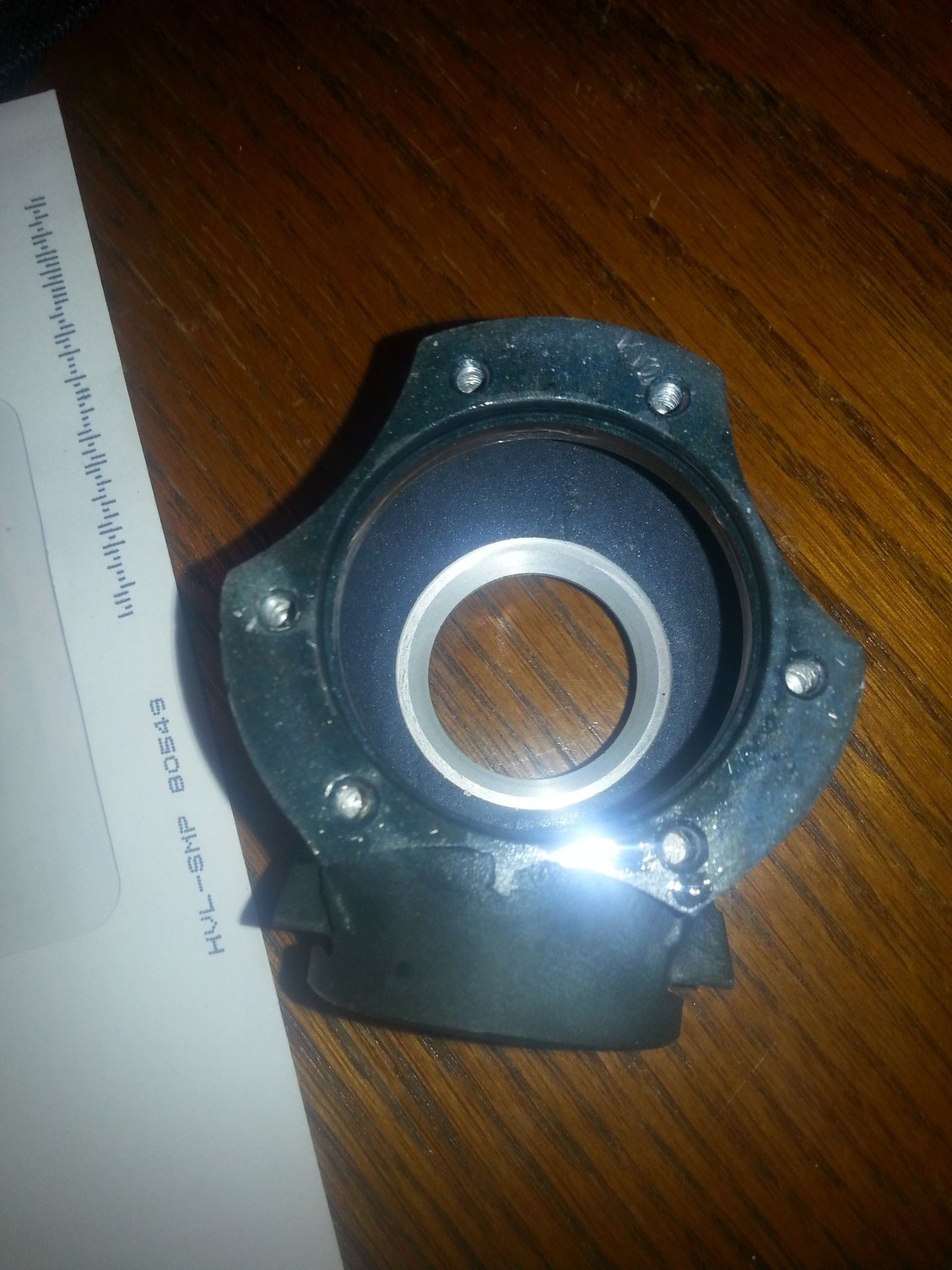

Is anyone using the new body on a DV successfully? I must have been one of the first to receive one. I had to buy a rebuild kit because the DV had a bad oring, but the kit doesnt have an Oring that fits. It looks like the receiving groove for the oring is just way too tight.
Their customer service sucks ***, I am trying to get a new DV or refund, hopefully MAP can do something for me.

Post up a picture of the new body, especially the inlet and outlet redesign, which is where there was a problem. I'm interested to see if they have fixed it.

I was told they are just now starting to fill backorders. I called them repeatedly, left voicemail, have two tickets open, and asked MAP to look into getting me some help. Yesterday was 3 months since I paid for the damn thing, and I am still on the OEM crushed DV.
Here are some quick cell phone pictures.
The rebuild kit came with a fat oring that I think is supposed to seat against the polished area in the last picture. The DV came with a skinnier oring installed, I wonder if its why the DV leaks at idle...
