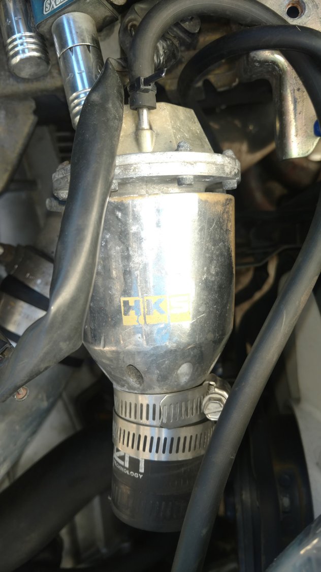

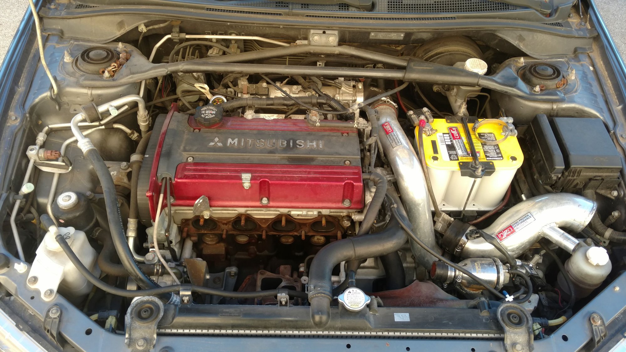

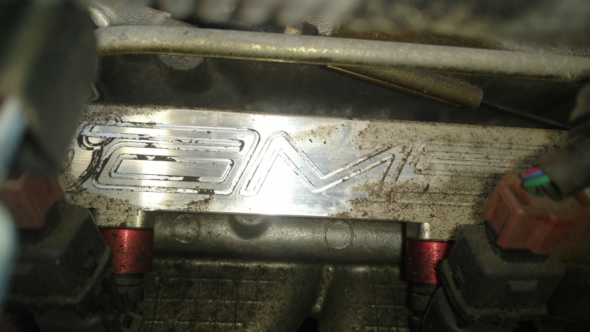

Old Dec 15, 2016 | 06:10 PM
M-A-T-T's Avatar
Joined: May 2010
Posts: 7
From: MO
Lightbulb Update
So, I believe I have wrapped my head around all this and here's what I've come up with:
Forced Performance Turbo CHRA
with
Forced Performance Evo 8 Install Kit
MAP Exhaust Manifold
GrimmSpeed 3-Port EBCS
Turbosmart IWG
TurboSmart Dual Port BOV
Here's some photos of the mess I have:
She needs a bath...
Old Dec 15, 2016 | 09:06 PM
mt057's Avatar
Posts: 1,529
Likes: 12
From: DFW
Looks like you have done some homework. Don't forget to shop around for a tuner.
