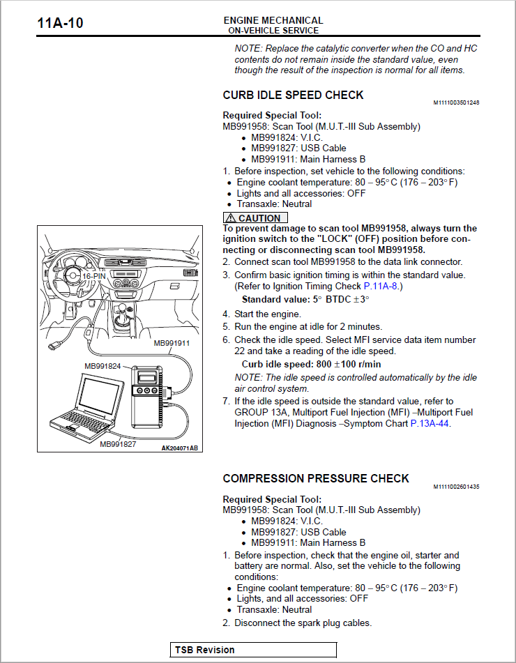

hate to break it to yah, but your engine is probably going to need a rebuild. That compression is either caused by bad rings or bad valve sealing. You can try adding a little engine oil into the cylinder and if the compression improves its bad rings, if not bad valve sealing.

Old Dec 16, 2016 | 11:03 AM
