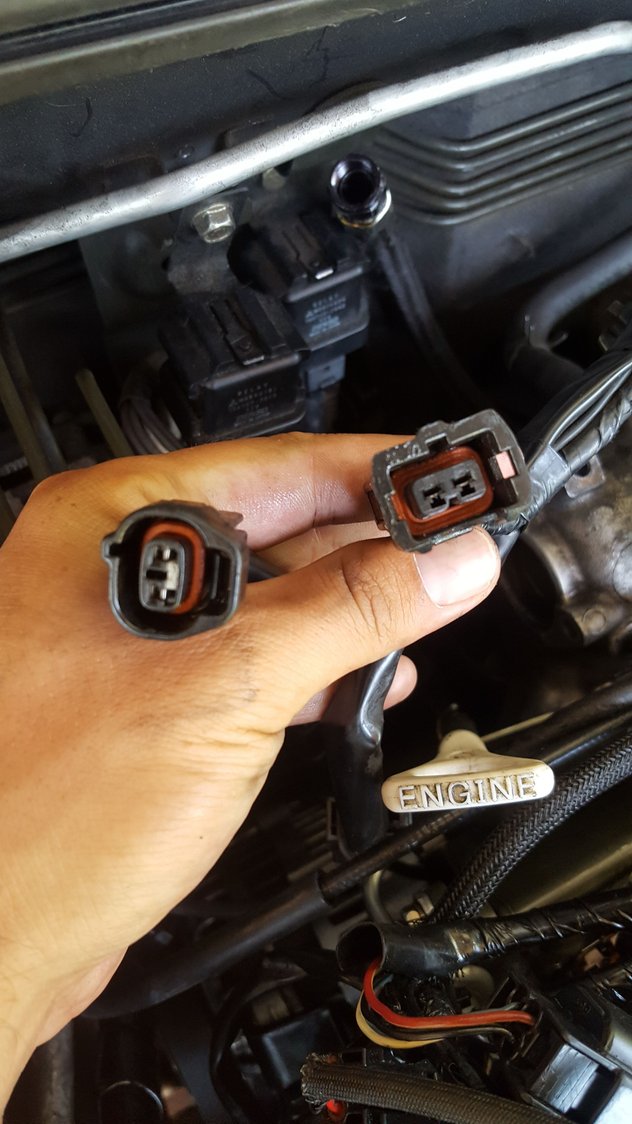

Help Identify these connectors
The one of the left is identical to the mivec solenoid connector and the one on the right is identical to an injector connector. There's a 3rd one that's brown color but I'm sure that's the egr solenoid. (Which has been deleted)
Thank you

The one on the right is for the OEM fuel pressure regulator solenoid. Not 100% sure about the one on the left, but the only thing I can think of in that area is the OEM evaporative emission purge solenoid. Most people remove these along with all of the EGR, as they are not really needed and sources for potential vacuum leaks.
that makes sense, thanks MasterNater. My EGR was removed so long ago I didn't remember it having 3 connections.
