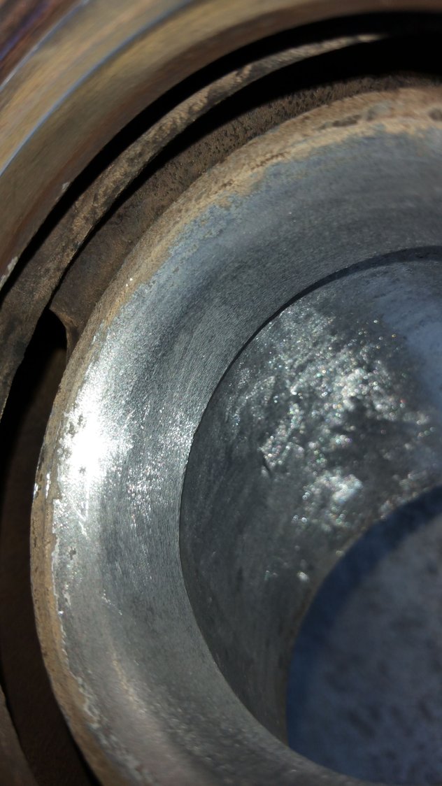

Does anyone know if the Evo 8 10.5 housing have a thinner volute? My E9 has a beefy volute.
