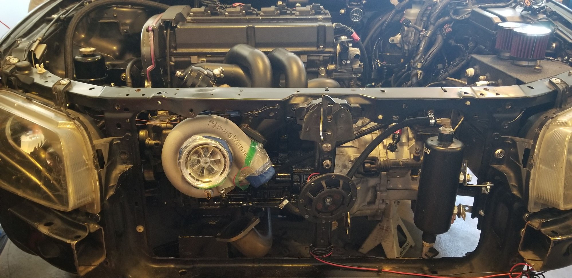

Test fitted the turbo today. Man its tiny compared to my 6466.

Old Jan 21, 2018 | 07:14 AM
  #81
RWD4G63's Avatar
Joined: Dec 2012
Posts: 153
Likes: 11
From: Mattawan, MI
Originally Posted by SnailSpeed
Any more info on this car? power figures?
He just got it on the dyno. Makes 520whp and 400ft/lbs of torque at 28lbs. He's going to run more boost but keep torque down as it's a stock block (lame I know). Also, boost threshold is a bit high because of the 1.22 housing (I told him it would), so he's considering moving down a size or two in A/R. I'll try and get a graph for you guys.
Excellent!
Looks like a consolidated runner T4 top mount.
Interested to see to boost plot or at least know when 28psi is reached.
