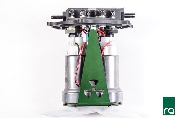

Wondering if anyone has feedback on the Radium Double Pumper? It runs either a single Walbro 450 or double. How much HP would a single 450 handle on E85?

I was making 550hp on a single 450. e85. stock lines, fuel rail, and fpr. with 1200cc injectors

Looks pretty if thats really a selling point. Glad they incorporated the mounting flange. Lots will buy it and have no idea how to wire it up. It only fits the 450 pump profile which many have bias against to begin with.

A single 450 with 2000cc injectors will make around 650ish depending on setup. You will also need a 6an fuel feed line.

Received the hanger 2 weeks ago, waiting on the inlet filters for the pumps.
Primary: -0267
Secondary: -0274
Will also have to redo the wiring. Primary pump is ECU triggered for load (fuel pump wire with high/low voltage circuit), going to branch off that relay to trigger secondary pump.
