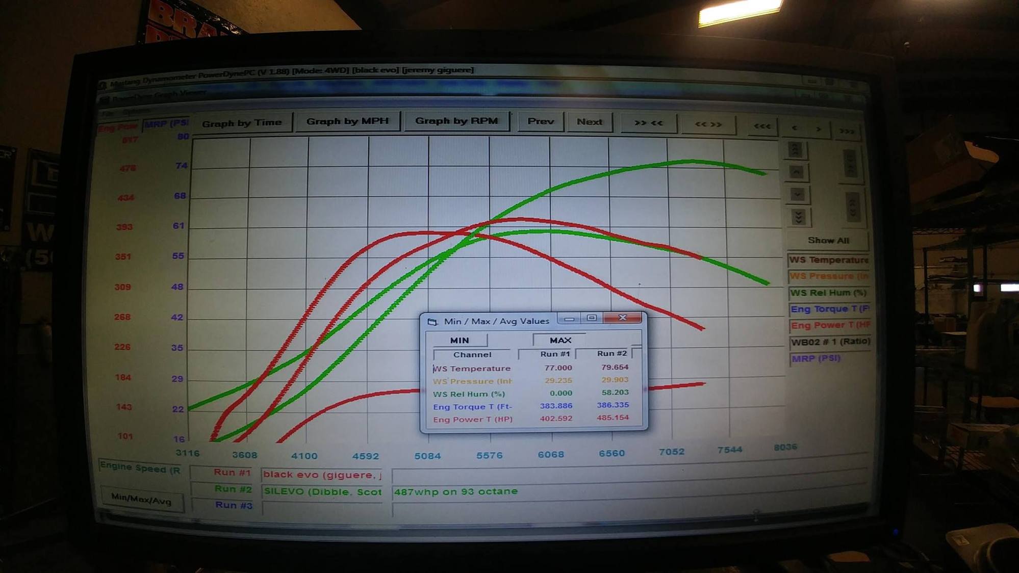

In the process of finishing mine up at the moment.
BR 2.3 rpm
Exedy Triple
Ported Intake Mani/TB
Ported Exhaust
FP Black jb mhi housing
FP 4R Cams
Main mods I guess. Car made 402/385 mustang dyno. 93 octane 27 lb of boost. Still on stock cam gears need to get adjustable to degree my cams in and work on power band. car is falling off after 6k.
Car makes 20psi at 4200. Couldnt run anymore boost because wastegate spring is to soft in the turbosmart wastegate i have. Tuner thinks we should see 500 on pump anyway once i fix a couple things. Car still feel great coming from the 2.0 with ported 9 turbo.
My car is the red the green is another 2.3 black combo.
