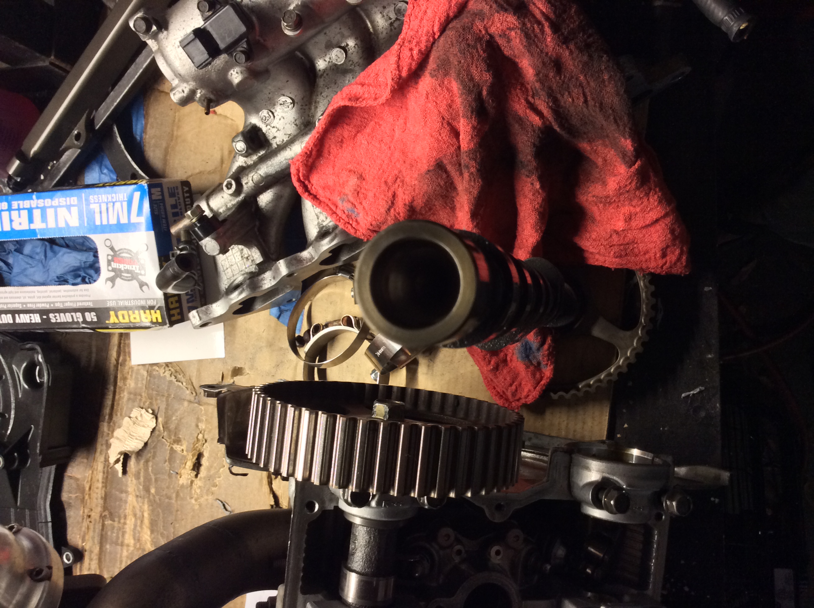

Bought a car and I was told the cams were aftermarket. Can anyone help me identify these cams

What do the scribe marks say?
My gsc s2 cams have that orange paint on them.
Remove the cam gears and look for scribe marks at the end of the cam face.

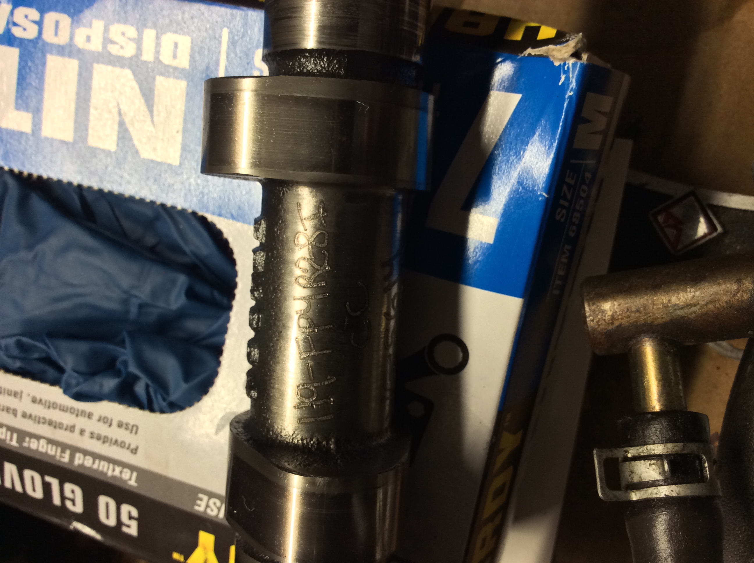

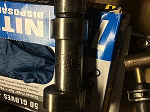

there are no scribe marks on either end of the cams
the intake cam is etched H9-FP4R2-8 Vg-564-09
ill recheck the exhaust cam

Judging by the marks I'd guess those are the FP4R cams. I dont believe Forced Performance makes them anymore. Search around on here and you should be able to find additional info on them.

yep Fp4r cams.
good cam
Lope harddddd

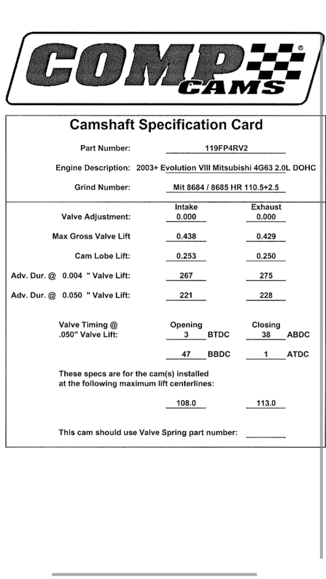

The FP cams are ground by Comp. There's a cam card with a part number floating around here somewhere.
