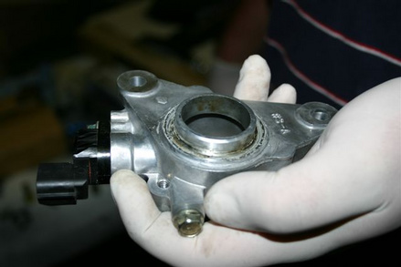

today when i started installing my GSC cams i accie\dently took out the cam angle sensor. the actual black part that has the wire that plugs into it. and i didnt catch it until i turned the engine over to reach top dead center. my question is am i ok just to put this thing back in or am i screwed or is there something else that i have to do. please help as soon as possible. i havew tried to include a picture of what i am talking about.

and oh buy the way i forgot to add. that my cam angle sensor is not actually off the car. it is still on the cam. where i am at in the cam install. is that i had just put the engine at TDC and started losing valve cover bolts and realized my mistake and stopped there. am i ok to just put it back in or is there something else i need to do

Explain to me in more detail exactly what you did. It doesn't sound like you "messed anything up". However, I'd say you have no business doing cams without someone experienced standing over your shoulder directing you. You could very easily cost yourself 3 or 4 grand in repairs at shop rates.

yeah i did print out a guide to do it but i just took out one thing that wasnt on the guide and i just wont to make sure that i aint messing anything up. the part that i actually took out is the lack thing that is on the cam angle sensor. it is held on with a 10 mm bolt. and it is completely round. once i took it out. i spun the engine around to top dead center according to the cam gear marks and that is it so far. i am kinda working on this in my spare time. but i did take that black thing out efore i spun the engine to TDC. then i realized what i had done and put it back in. it went in as easy as it came out. so i think that i am ok. but i just wanted to e sure. other than that one hiccup everything else has been going smoothly. and i have done cams before just not in an import.

TDC on the cams is good ONLY if you ALSO have TDC on the crank. Check all three and if lined up, you should be good. Also bleed the slack adjusters. There is a big thread on here that explains how. Let me know how it goes. Are you going this Saturday to vivid?? Ray

yeah all three are lining up ray. and i should be up there on saturday if i can get my car together honestly i am just working on it in my spare time. i just wanted to make sure that i didnt mess anything up with that lack thing that i took out from the cam sensor. it actually is very easy to do cams. it is just that i dont have a full day to work on it to knock it out(i am going extremely slow on this cam install). but if i get stuck ray i will give you a call. i can get your number from mike.(grey evo with galiga front bumper). and actually TDC on the crand is a little bit off maybe a degree or two but i heard that that is ok

o.k. good and do a few rotations of the engine. My crank was 1 degree off. So i would say you are good. Hope to see you guys Sat. I will try to figure out when and where we will meet Sat. morning and post it all over. Ray
